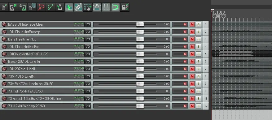

I just ran my gear thru a shootout to see what sounds best to my ears and is non-biased as I can be, as I dont really care....but I do expect more from more expensive stuff.
in short I plugged the Fender P-Bass into:
1)Interface DI
2)Interface DI with Realtime Plugins
3)JDI into MicPre/Interface
4)JDI into Cloudlifter into MicPre/Interface
5) JDI>Cloudlifter> MicPre/Interface >Realtime plugins
6) 73Pre into interface(line in)
7) 73Pre into KT2A (line in)
8) JDI>Cloudlifter>Outboard preamp> Interface /Line IN
**my least fav's 1,3,4,6 were the "missing something" group.
being older Ill use a Beatle analogy...
its like #7... the 73/KT2A gets up to the Rubber Soul album...where things were straight forward and cleaner in a compressed way, ...analogish....plugin, hit record an play.
Then theres #5 & #2 ..the PlugInAmpSim approach that can offer Revolver, SgtPepper through MMT. ...flangers,verbs triple comps,eq, wahwahs telephone voice wangyflungshinz noises... (the PluginAmpsim can also do AbbeyRoad cleaner, with rich chamber verbs) and offers more technical stuff like RECALL, SAVE AS and all that.
food for thought...pondering in gear land...

Have you listened to each within a mix yet? The reason i ask is I just finished my own sort of bass recording test but with an amp. I was trying something different from the usual dynamic in front of the speaker (Oktava MK219 around 2 feat from the cab) and found that in order to get a track that fit with the rest of the instrumentation i had a crazy eq on the amp that literally sounded horrible in the room. A great bass sound by itself can often interfere severely with the sound of the kick in a track.
true....all the shoots dont mean much in a mix..lol
crazy but youre right. I remember a mix class article the dude said "dont waste time on solo tracks!!" why waste the time?
in real world we are really looking for crap-gear maybe?...and most pieces arent crap. a cheap DI or a plugin...or a $1000 preamp...
and then in the mix we slather the plugs and eq on.... so the original track is unrecognizable. at least imo....
good point, reminder! like microphones...spend all the time doing comparisons and full ness...and the first thing turn on the HPF...lol
That is a huge amount of pre-processing. My bass goes into the front input of the interface. That's it - one cable. Once it's in the machine, I can fiddle and tweak without compromising the pure signal the bass stuck out. I never pre-process unless there is a really significant reason - maybe like some strange playing style that needs gain adjustment, or because the recording signal is being 'sniffed' from the path the bass takes to an amp or other system, and I have no choice.
Is your bass very low output? My jazz is easily able to make LEDs go red at half gain - so why the cloudlifter? This is very odd?
...so why the cloudlifter?
I’d imagine an attempt to make up the stepdown loss from the DI in hopes it will be less noisy than just getting extra gain from preamp.
I had trouble figuring out if the OP was about getting a decent final tone or just about satisfaction during tracking. In either case really I’m not super surprised that the clean flat sound of the bass was less enjoyable than when it’s been compressed, saturated, and filtered.
