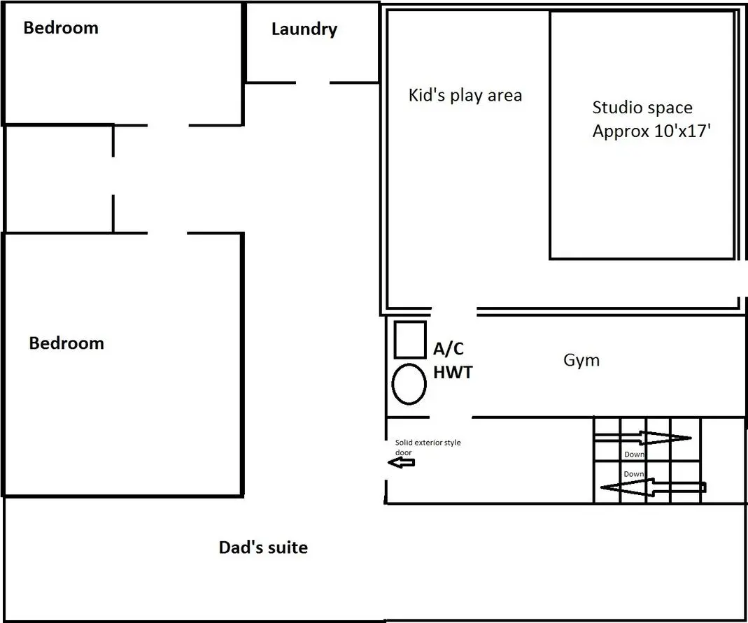

And here is what I am planning on doing for the studio space

What is the break in the exterior wall on the right in the bunker? How do the stairs land?
lou
Thanks for the reply. Yes, the electronic drums are much better for noise which is why we have them now, but my son is a drummer and I would really like to get the drums for him.I do record digitally, and I will probably continue to use the electronic drums for simplicity, but want the acoustic drums for him. The "studio" will be as much or maybe more of a "practice room" than a studio.
The break is an exterior door. The house is built on a slope, so the front side of the room (top of page) is under ground, but the outside slopes down to where that door is.
The section of stairs at the bottom of the page is where they land.
I can't picture the stairs at all. So access to the bunker is from outdoors and/or under/in front of the stairs and through the gym/utility area? Will both bedrooms on that level be utilized? What time of night will someone be in them?
lou
Sorry, my sketching abilities are not great. But yes, you have the idea. Access is from the stairs, through the gym/utility area, or from outside.
The bedoroms are in dad's suite. The one on the lower part of the page is the one he will use. He probably goes to bed around 9 or 10.
The stairs are split - I get it. Do you need the outside door? Hallways are space eaters. Having said that the placement you have for the music room does give you maximum buffer to the Dad space. Both your new walls and the existing walls will need to be treated for isolation as well as the ceiling.
The real experts will need to take it from here.
lou

Yes, the stairs are split (sorry, not sure how to draw that). unfortunately, I do need that exterior door. I wish i didn't because it would be nice to have space that the new hallway will take.
I also agree about the electronic drums for recording, and I will continue to use them, but we want acoustic drums for my son to practice on. He has been playing the electronic ones for the last few years, but has now gotten to a skill level where he needs the real thing. They won't be so much for recording, but for practicing and jamming.
Does the outside door have to provide access to kid space and studio both? If only kid space you could split the bunker equally horizontally and access the studio through a new door near the laundry. Or split it vertically and cut a new door in the gym for interior access to whichever needs the outside door. Just trying to maximize studio space. Either of these options may make isolation from Dad more difficult. I think you're gonna have a tough row regardless with acoustic drums and your original idea will be the easiest to isolate somewhat.
lou
Thanks for the suggestions Lou. I was also trying to figure out ways to maximize the space, but I do need the door for the studio space. I teach guitar lessons, so that door will be used for students to come and go. It will also be easier for taking gear out for gigs.
The sketch is better now. You are gonna have to get some input from people with isolation engineering skills involved. Have you gone to John Sayer's site yet? John Brandt is a member here, with any luck he'll pop in.
My last gasp to get more room - Can the second bedroom be used for the kids playroom? It's not that much smaller than what you drew up and doesn't a 20X20 studio sound nice? ;)
Good luck, Bri. We're way past the point where I can be useful.
lou
Thanks for all the suggestions Lou. I would LOVE to have a 20x20 studio! But that second bedroom is in the father in law's suite, so it is not in my part of the house. We just have access to the gym and bunker areas.
Bri,
Yes, you will need to build at least 2 decoupled walls and ceiling. The concrete walls may only need resilient clips & this would help utilize the most space. Do you plan to do the building yourself or hire it done?
The sound pressure level of drums can reach to around 105 decibels so you may need at least STC67 partitions if you plan to play when someone is sleeping or 'annoyable'. o_O
