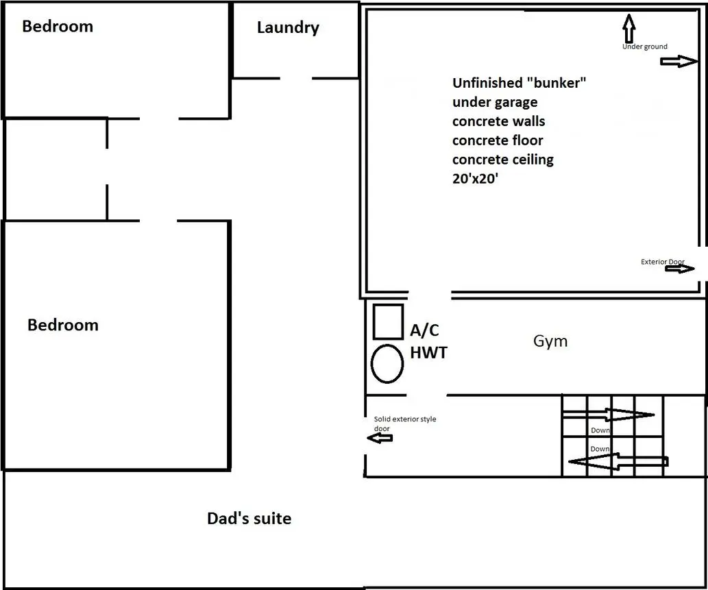

Okay - we're getting somewhere. I think having the playroom between you and Dad will be a good thing. You should look at the playroom as part of the isolation strategy for Dad. Big air space = good thing. Plan on treating the wall separating the playroom from Dad fairly thoroughly and you can get away with less on the wall you will be building.
Forget about isolation to the playroom. Not gonna happen. You can damp it some so the tykes don't get hearing damage but they will certainly hear you and likely vice versa. Scheduling studio time, specifically tracking and jamming, is probably the only way to reduce conflicts. Listening and mixing should not present a conflict. I hope nap time isn't part of the playroom activities.
You will need to do some real work with the air handling - sound will run right down the ductwork. Baffled boxes are typical but vibration damping will be required as well to keep Dad from picking up bass.
I am running out of expertise but everything I've just told you I picked up right here and at the other sites. You will learn it as well.
lou

I created a rough sketch of my space ans saved it as a jpg, but how do I attach it to this thread ?
Hit reply/go advanced/manage attachments. Upload it from your HD and drag it into the box. Done.
lou
Here is the space I will have when we move in next month
