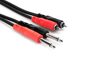

An alternative simple test would be to get and try 1/4" TS(not TRS) to RCA cables.
Great idea! Thanks a lot! I briefly tested the speakers from an iPad using a minijack-to-RCA, and it worked perfectly. It must be either the cables, as you're suggesting, or some software setting.

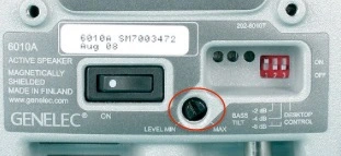

There's actually no level control, only some little switches you can flip over with a screwdriver depending on the monitor positions.
Are you certain? Any images I looked up have level control.
Maybe your model is an older version or something?

Don't worry about it. Simply put XLR-RCA can be internally wired one of two ways.
If you're sure there's no level control, or it's already turned up, I guess your cables are the wrong kind.
1/4" TS to RCA (x 2) as pictured don't have the same confusion or option.
