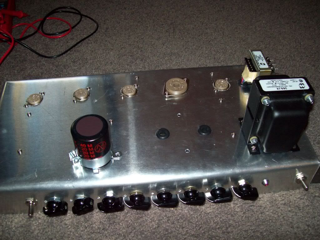

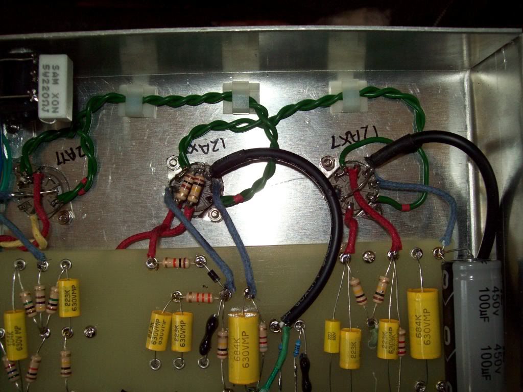

OK, getting really carried away and probably showing off to some degree, but..
Shots on my AX84 'October Build. Built a 'P1 Extreme' first and then the 'October'. My guitarist son says the October can do anything. Great for studio as not so powerful. He also loves the Weber JTM45 clone, but MUST wear ear protection to get the distortion he wants. Hence the October.
Happy to answer build questions if I can:

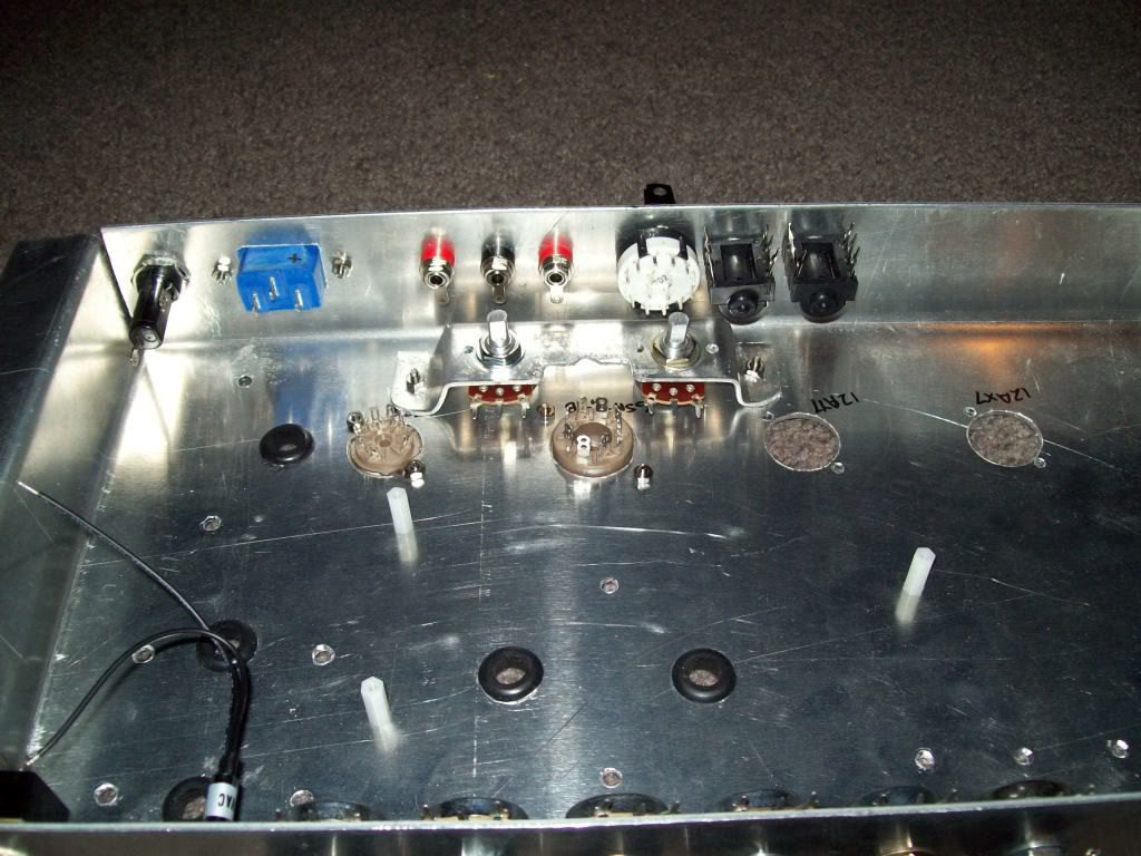

Bent up my own chassis:

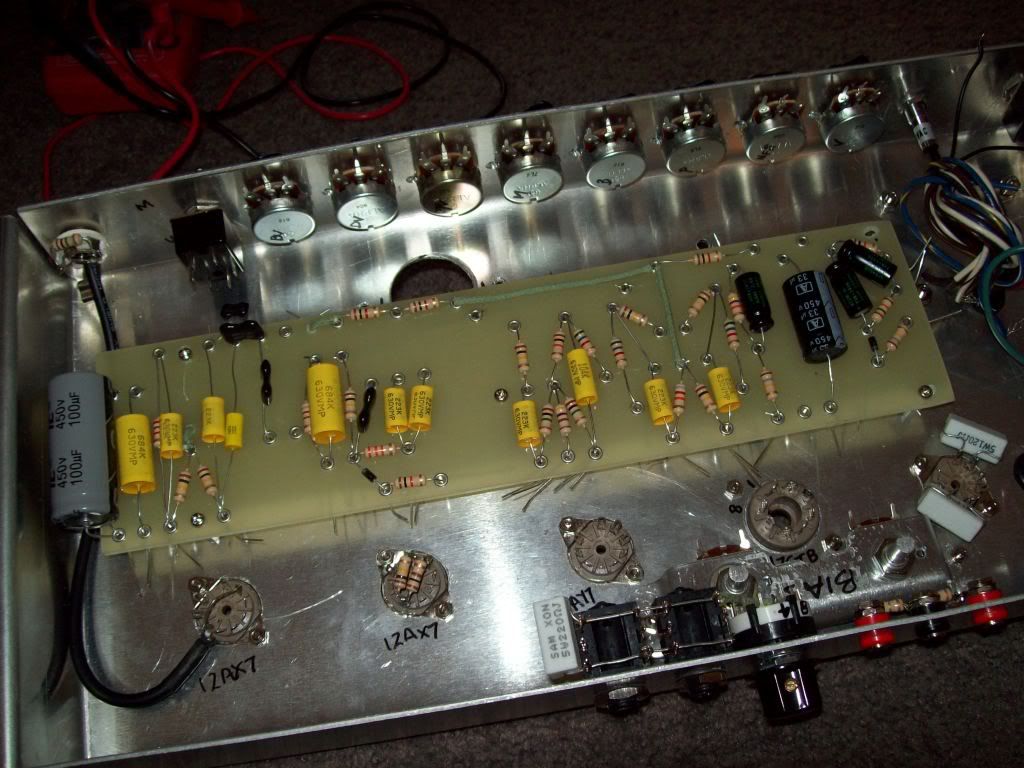

Drilled and made my own board and put in eyelets. Also needed to put in full size bias pots as I could not get the right value in a smaller size. Made up a aluminium cover to hold them:
Gets a bit tight at the main valve:

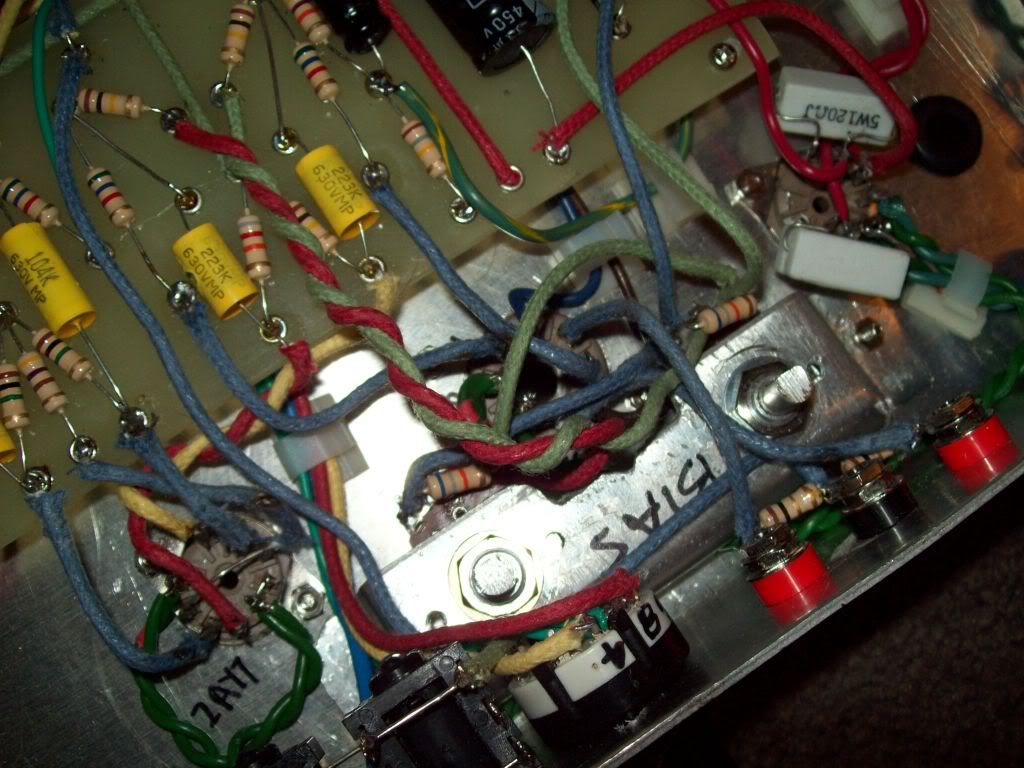

Point to Point Wiring mess:
Nearly there:

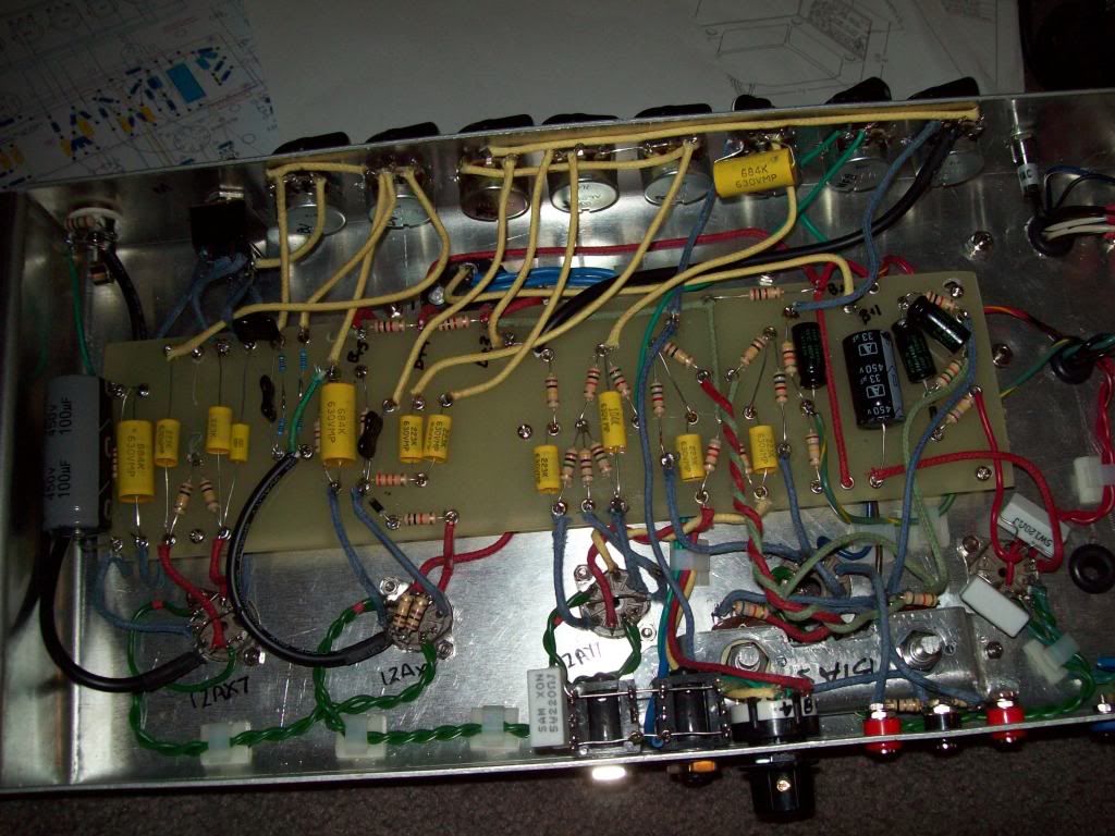

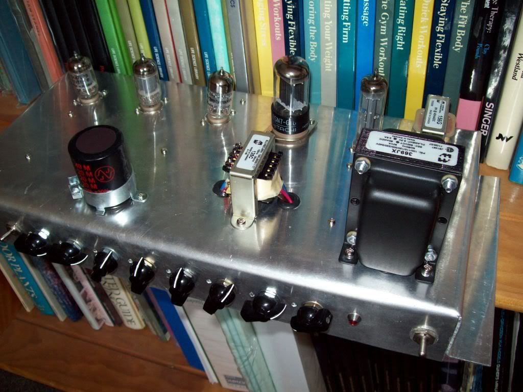

Completed. Sound bites soon:
