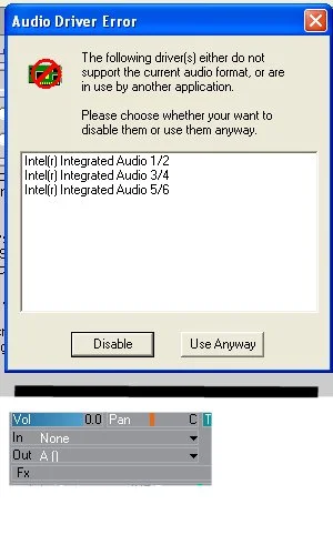

My soundcard is now operating perfectly thank you. Except I am having the small problem of not being able to work in Cakewalk HS 2002.
My soundcard plays everything in Media Player fine, I can record on Goldwave and Sound Recorder fine, etc. Fully functioning except when I load up CW I get an error.
I have uninstalled and reinstalled to no avail.
I have provided screens of this in the hope you may be able to guide me into fixing the problem.

Sorry, I wasn't aware of that error.
What happens if you click "use anyway"?
Do you have another audio application running at the same time?
Cakewalk have a "share drivers" option if there is.
That's the most likely cause - maybe you have Winamp, Realplayer or something running in the taskbar - exit them!
No I have nothing running at all in the background or anywhere...
If I use anyway I cant select the playback or record arm.
Even so, can you try the share drivers and use MME interface options? Close Cake, reopen and see what happens then.
If all else fails, open the Cakewalk folder and find and delete the file "audio.ini". Even though you reinstalled the program, this settings file may have remained from before and picked up by the new installation.

I deleted it... It run a test, and then I am back to that same error again.

Well, I think we've proved that something in the audio system is upsetting Cake, but apart from the drivers you have being faulty (possible, Cakewalk acceses the drivers in ways that other programs don't), the only thing I know of is contention with some other audio driver in your system.
Possible causes (in the Sound, Video and Gamecontrollers entry in hardware manager) are....
Wave device for Voice Modem.
ATI Rage Theatre. (This is the sound driver of All-in-Wonder video cards).
Right click and disable any of these.
Going back, I did suggest that you changed some settings in HS Options/Audio menu - the "share drivers..." and "Always use MME...". Were you not able to try these? You haven't said.
THe MME one is the clincher - the difference between Cakewalk and other programs. The others use MME anyway, and you say these work. Cakewalk has a special fast access mode that only works with well written WDM type drivers. If they (the drivers) are not - you must Check to use the MME option.
The checkboxes are on the Advanced Tab and you'll have to get past the error warning by "use anyway" to change them.
Actually. I'm assuming you have a WDM type audio driver on your PC - you haven't stated what version of Windows you have.
If Windows98, you will almost certainly not have WDM in which case none of the above option checks will have any effect.
You can have WDM type drivers with Win98SE (and WinME) but most basic soundchips never had these produced for Win98SE.
Jim Y you totally rock mate... Thank you for all your help I have fixed the problem. Thank you once again.
