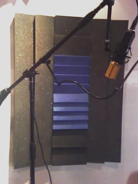

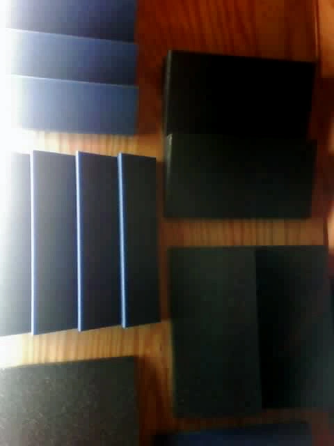

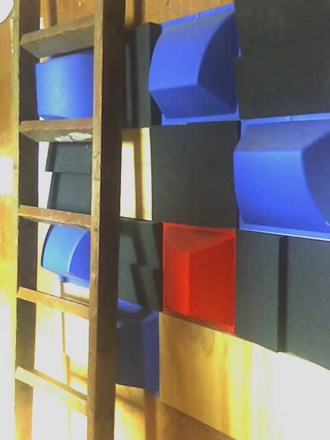

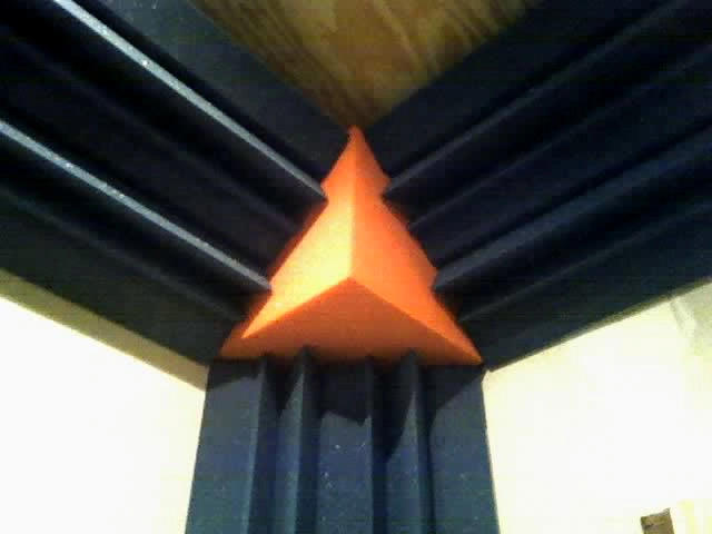

Here's what I did with mine, auralex recommends not puting panels acrss from each other, it takes the even look away, but sounds way better.

Also, the 3'x4' panels are mounted on 1/4" plywood. This is so they can be moved easily, with nothing more than a couple of screw holes to replace.
This also helps with extra vocal trackings, I can hang them from a counter weight boom stand, like gobos. Nice when my other gobos are being used elsewhere in the studio.

Thanx Blue Groove for the pictures! :)
