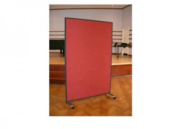

The reason to get a sub was to maybe get 3" monitors (due to limited desk space) and a subwoofer for the LF.
I was hoping to make a small box like the one in the video below to be kept on my desk when the mic is in use.
YouTube
and make some floor standing screens (see picture below) that can be behind the vocalist and can be folded and kept away when not in use

The screens need to be absorbent, 1/8" of fluff on a board won't cut it.

On the reflection filter/homemade box - the general consensus (but not unanimous) on these is that they make the vocal 'boxy - because they reduce all the high end, but not the mids that contribute to the boxy sound. So you end up EQing to reduce mids and boost highs/'air'. I've found (in a small room) if I have the mic set up so that I'm facing a 'V' of two bass traps (4" rockwool), I really don't have to worry much about reflections coming back to the mic from the back or side walls (yes, those are treated, too), because the initial sound is getting truncated before it starts bouncing around

Not really useful. The mic's pickup pattern is going to capture mostly from in front of it, and it's the crap bouncing around the room that is going to get in, anyway. And the mics you're looking at don't have a desk stand.
Panels on the wall and overhead are a lot more effective. IME in a small space, you just don't accomplish much by trying to do setups and teardowns everytime you want to record. It is far, far more conducive to recording if you can just open the DAW and "push the red button" to get started.
