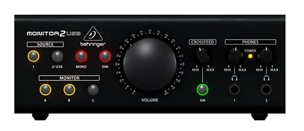

Behinger makes some headphone amps that are cheap, the power play is popular.
I always wanted to try the MonitorTwo..Behringer HA
