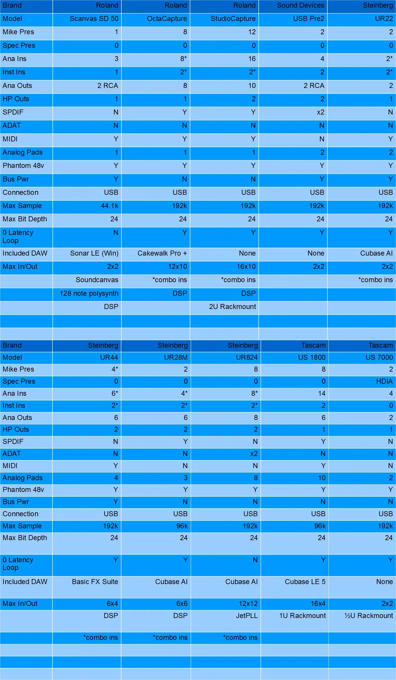

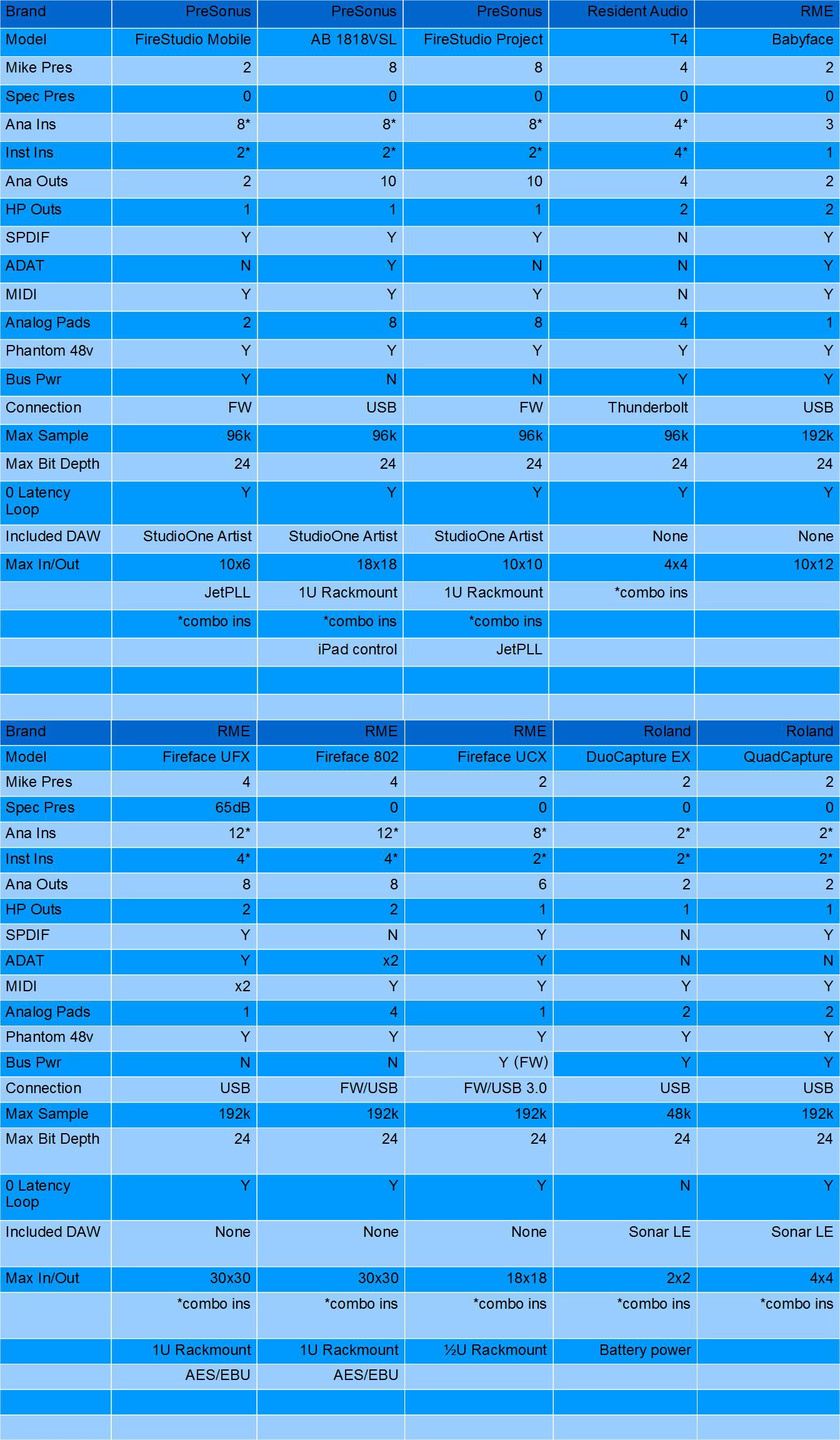

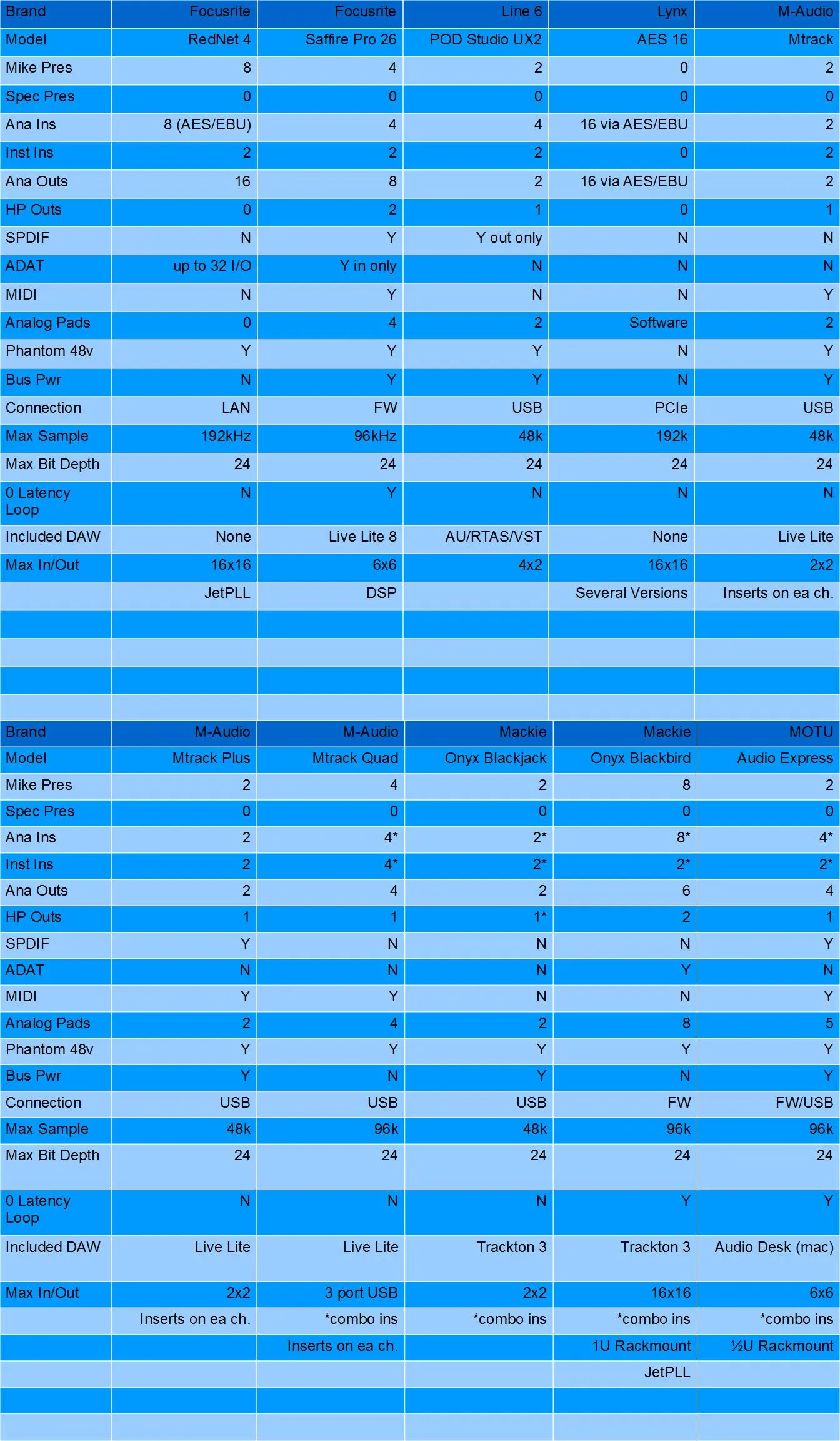

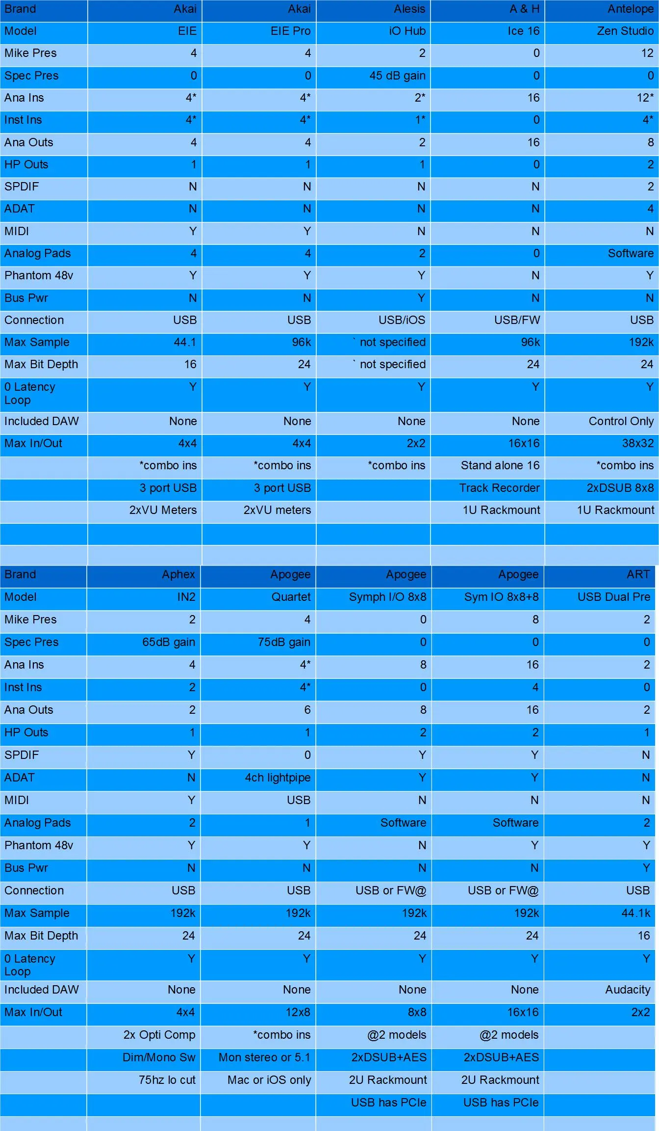

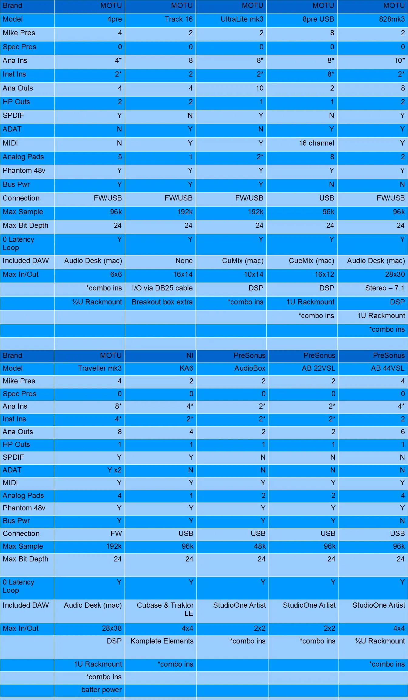

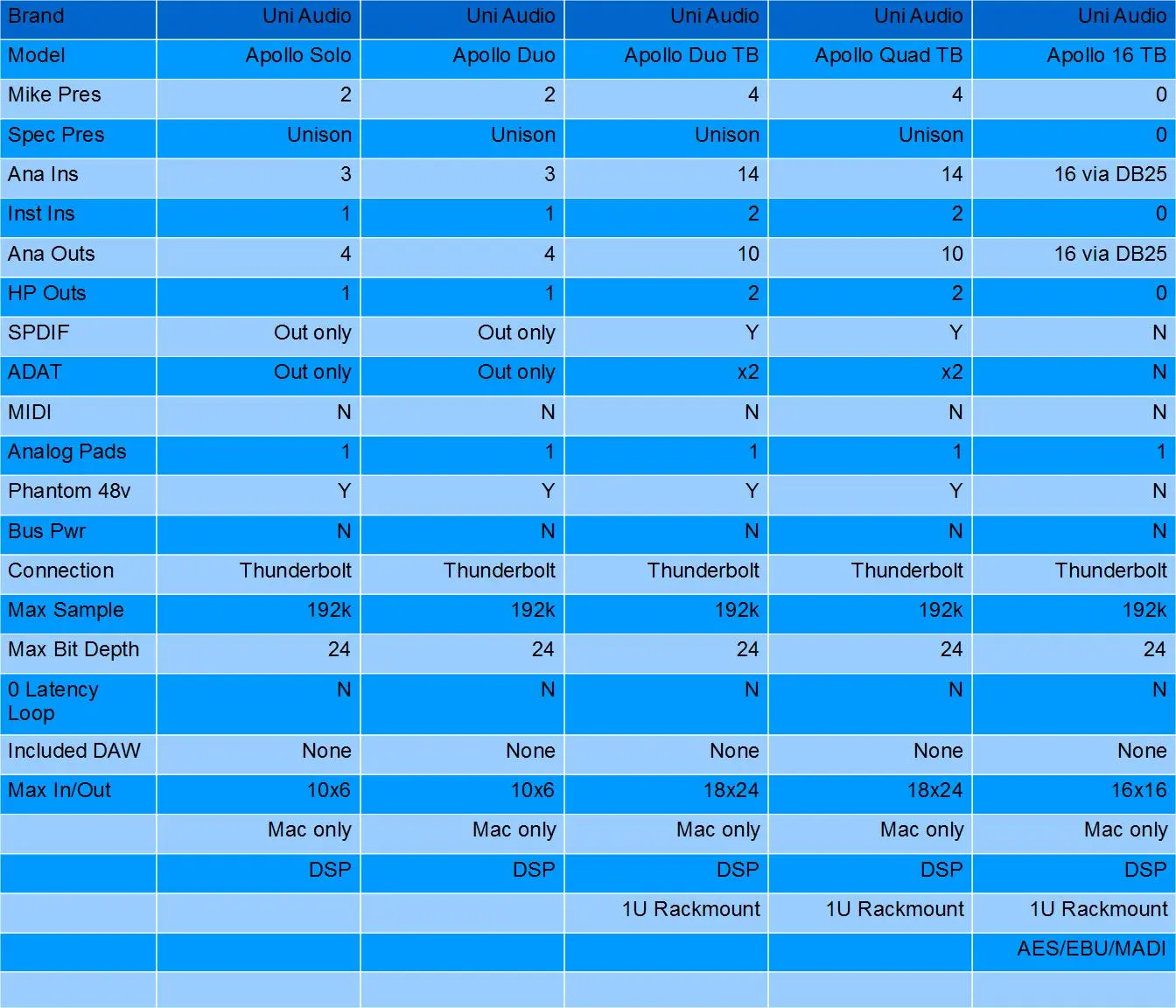

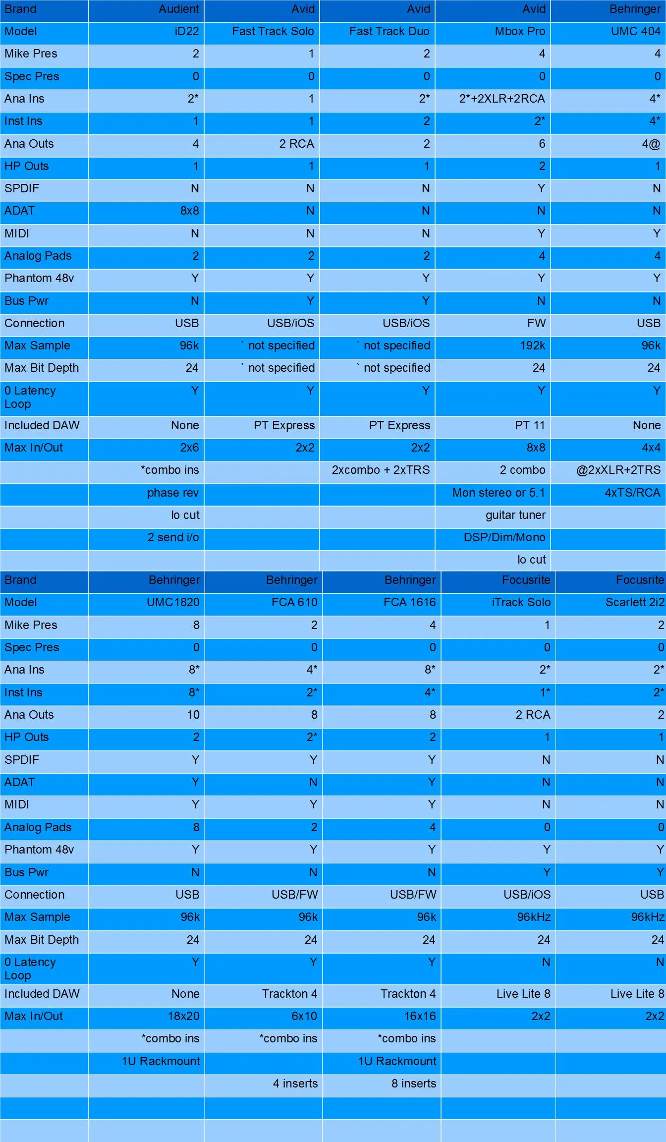

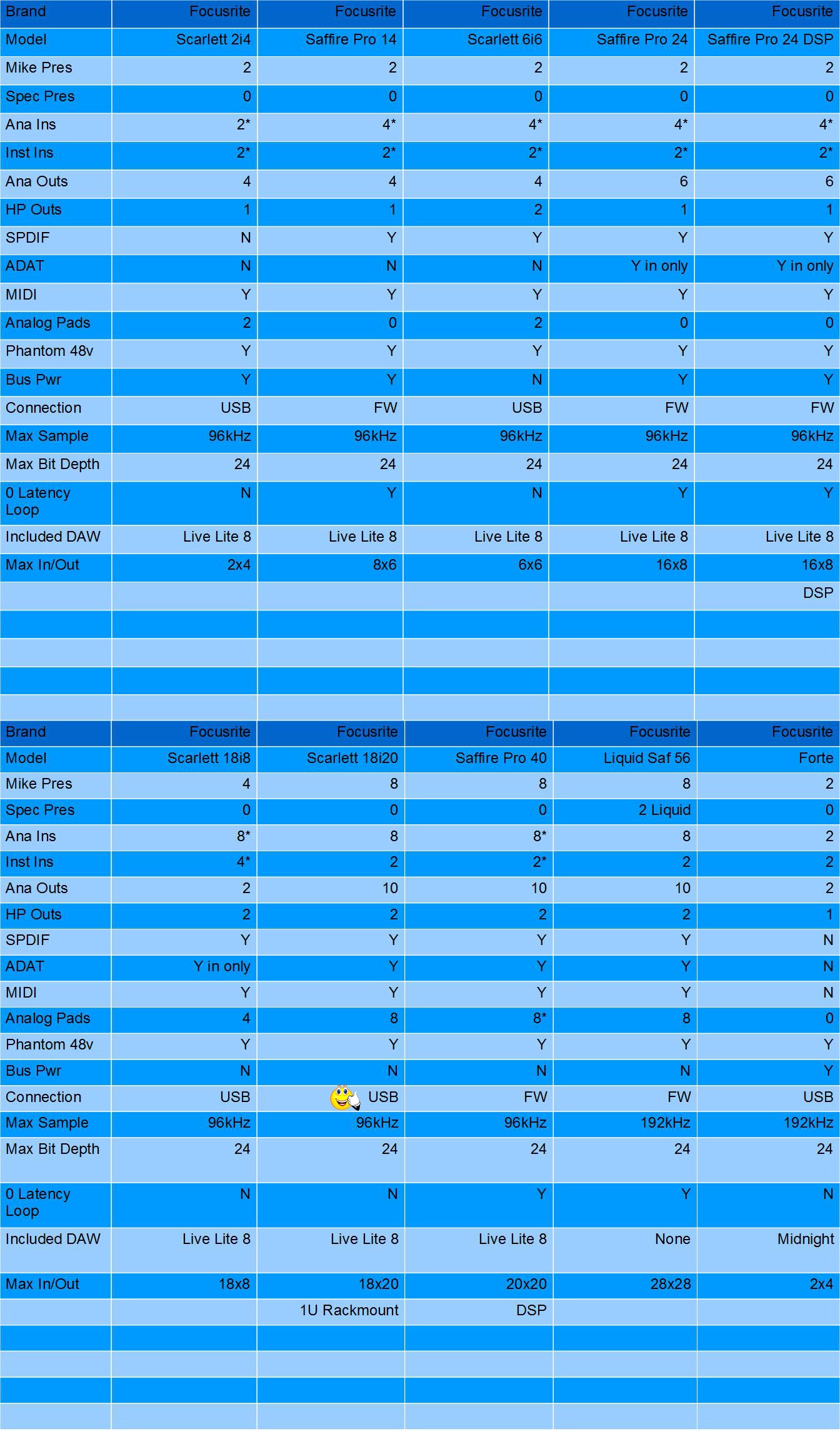

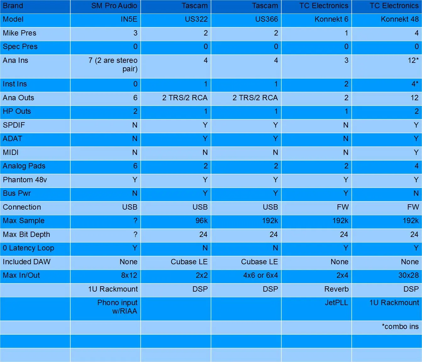

Okay, I threatened. Here it is.
Chart 1.webpChart 2.webpChart 3.webpChart 4.webpChart 5.webpChart 6.webpChart 7.webpChart 9.webpChart 8.webp
If you see errors or omissions, let me know and we'll fix it. Hopes this helps newbs...

Funny, the US200 and US600 and US1200 as well as the 322 and 366 are not in Sweetwater's lineup. (where I got the models). Have to add to the info.
The 200, 600 and 1200 are actually dropped from TEAC's lineup, but I'll get the 322 and 366. Was doing this for newbs to use as a reference for interfaces to buy.

Something that might be worth adding for the RME Fireface UCX: It can be bus-powered if using firewire.
Thanks for the info. I'll see if I can fix that today. What these need are reviews! If we could get people to post reviews of the devices they own/use...:)

Fosusrite 18i20 is USB, not firewire. Trust me, I own one.

Yup, my bad. I'd fix it, but I can't edit the original post anymore. Hopefully people read the whole thread...
I got your back, brother. Take a look ;)
Awesome! Thanks a bunch. But you left the old image at the bottom? Don't need it twice. :D
That was a lot of work, I'm not surprised there are a few errors in it. If you go back can you make the note about the RME UCX's bus power with FW? Just change the N to a Y (FW) or something similar...
