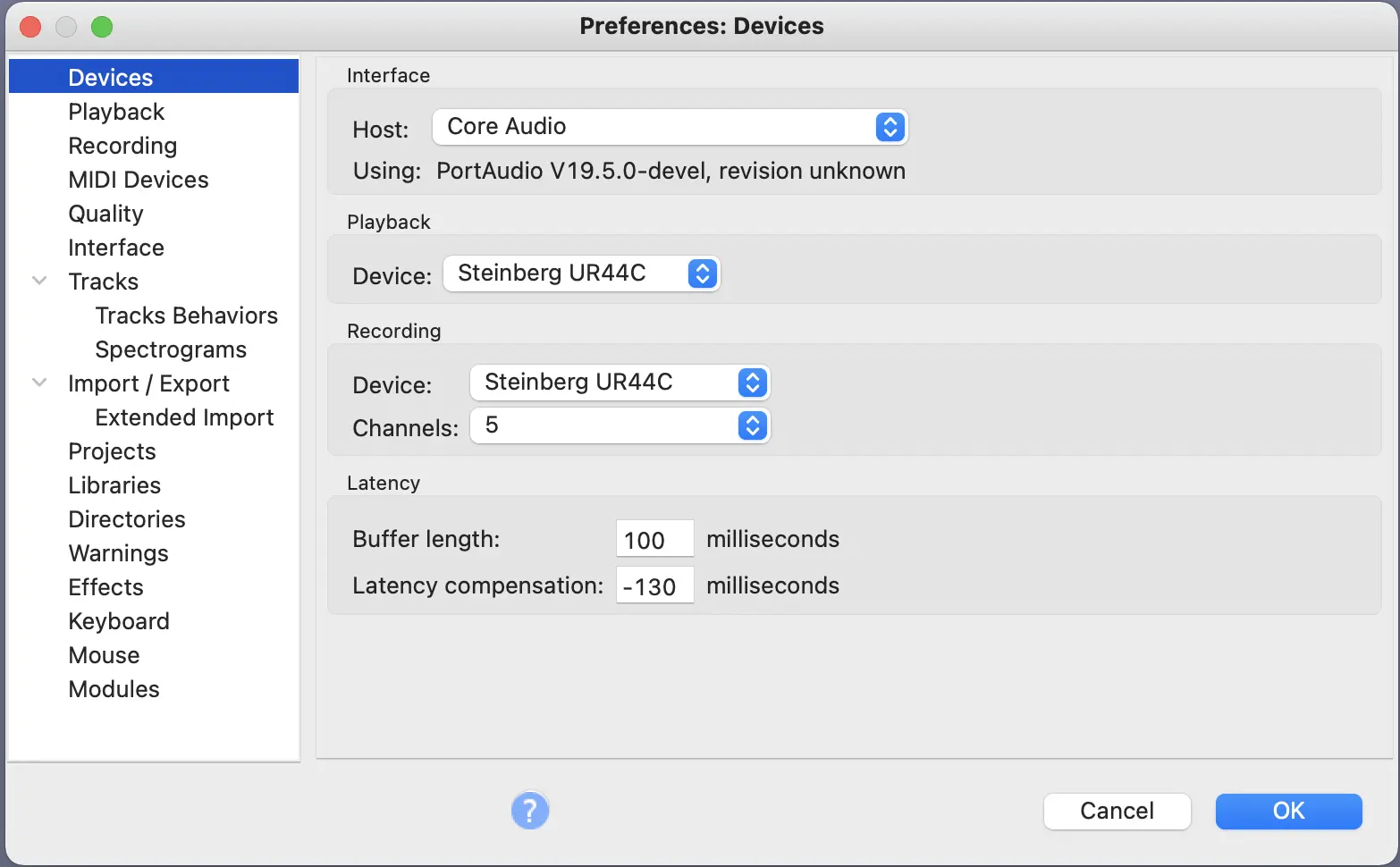

Did you set Audacity's Preferences to enable 8 channels? (Attached is 5 channels enabled with my UR44C - just to test channel 5, a line-level input.) Then, add your 8 tracks. Each should automatically increment to the next input.

Thanks, Keith. I tried it. Your screen shot doesn't open for me, so I tried going to Audacity > Preferences > Devices, selected eight channels, and hitting OK.
Then I created eight tracks, selected track 2, plugged the mic into channel 2, hit the red Record dot, and sang some light opera (since I was in the aria). Didn't get a sound.
Is there something else on your screen shot? Folks at posts 2 and 4 said I can't multi-track on Audacity.
