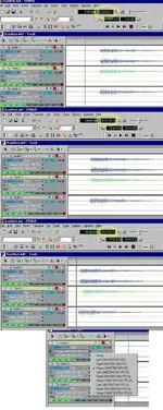

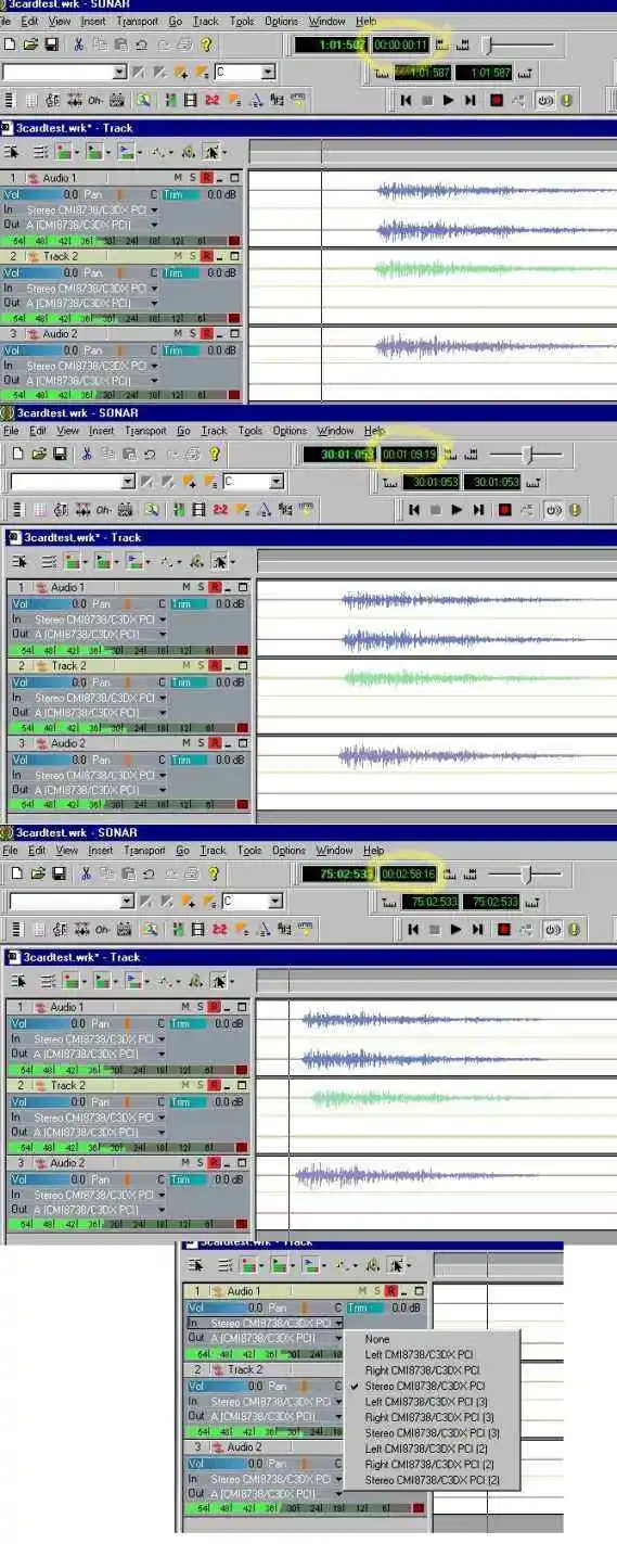

Well, the results are in, and it looks like Slack was right (see attachment).
There is a hair of drift at the 2 and 3 minute marks. Keep in mind, the waveform you're looking at is a fairly staccato closed hihat sound zoomed wwwaayyyyy in. I'm not sure how many milliseconds that is, but it's not much. Even at 3 minutes, the drift is inaudible. I think that it'll still be good enough for my purposes, as I'm not recording anything over 5 minutes anyway, and I can do a quick slice & dice or 2 if need be.

Does sonar have a timeline? That looks like a lot of drift between the first and third card ...like a 1/8 to 1/4 of a second?
I'd recommend that you make sure to keep instruments seperated between the cards. In other words, don't use more than two mics on any one instrument, and make sure no instrument gets split between two cards. It could be an interesting effect though. :)

Sonar does have a timeline, but it's zoomed in so close that none of the ruler marks are in view. I circled the time at the top of each screen to show where the time is at. It's nowhere near 1/8 of a second, though. The waveform is one staccato hihat hit, and I can't hear any of the drift at all at 3 minutes. I'll check it more closely when I get home tonite, and figure out how many milliseconds it is.
