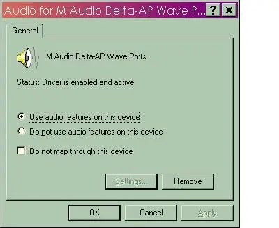

I'm still not where I need to be on the driver update issue. I followed your map to the M audio driver properties but there was no option there to update the driver! See atatched...

Hey Rats,
I am using Windows ME and have a delta 1010 and 44. Just this past week I was looking to update my drivers.
heres how:
control panel/system/device manager/sound,video,and game controlers/M audio/driver tab/update driver.
The thing is.....I have been using an older version (one of the first ME drivers M-audio put out) and dont have any problems , .........except sometimes i get a pop at the begining of playback. The update is supposed to fix this.
When i run the update i get a message saying something like...the one im using currently is better?
dont know what to do.
hope this helps,
rodvonbon
a round of applause for rodbonvon! Ok so now I have updated my drivers!
