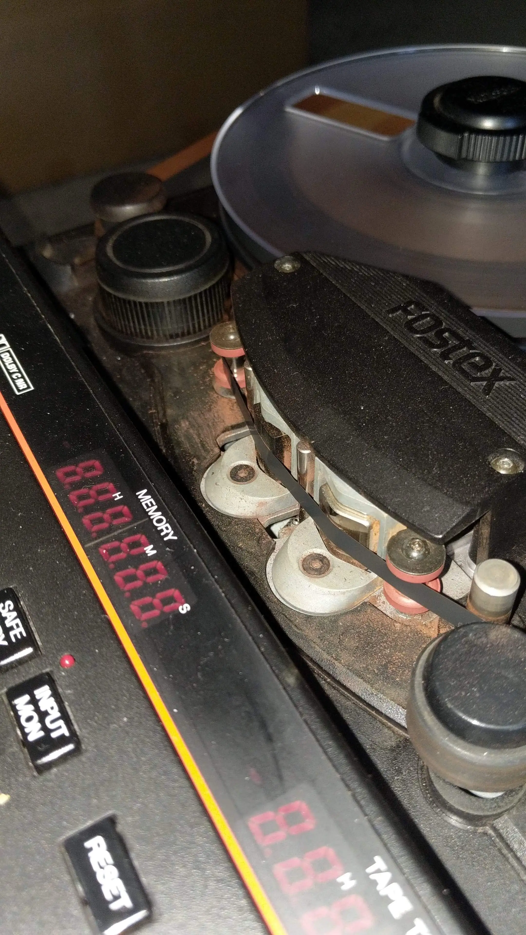

I've been recording a 10 min track on a newly serviced Fostex R8 and I'm getting a lot of she'd off this new reel. The tracks are Recording fine with no dropout's but why is it shedding this much each time I track? Is this normal? Is it just the deck being a cheaper one and having alot of friction by design? I'm very confused I was under the impression she'd happens but this seems extreme. I've cleaned the transport 4 times since starting this song and I'm only 4 tracks in.
That looks like edge damage to me, and there may be a reason for that.
If this machine is new to you, it's possible it's spent most of its life running Ampex or Quantegy 457. An interesting quirk of that tape is that Ampex supposedly had a few issues slitting it neatly, and as a workaround slit the tape bit thinner than the full 1/4".
As a result, there have been a number of reports where a machine has suddenly been given RTM or ATR tape after decades of use with Ampex/Quantegy, and sheds all over the place. This can happen when there's an Ampex-sized groove worn into the tape path - you get edge damage because the properly-sized tape won't quite fit. IIRC the solution is to try and ignore it until the groove has been widened through use.

If I were you Jzoha18 I'd try Recording The Masters (RTM) LPR35 or SM911 tape in 7" reel. The LPR35 is 1.0 mil thick, supposedly equivalent to Quantegy 457, the SM911 is 1.5 mil thick & equivalent to Quantegy 456. I have read another person's recent post on TapeOp with a R8 and prefers to use SM911 as the bass is better with the thicker tape. RTM bought out RMGI I think. I wouldn't spend any extra money to recalibrate your R8. Just try it with RTM. Clean the tape path constantly when using the R8 and demag frequently. Treat it good because spare parts are difficult to find for Fostex gear.
