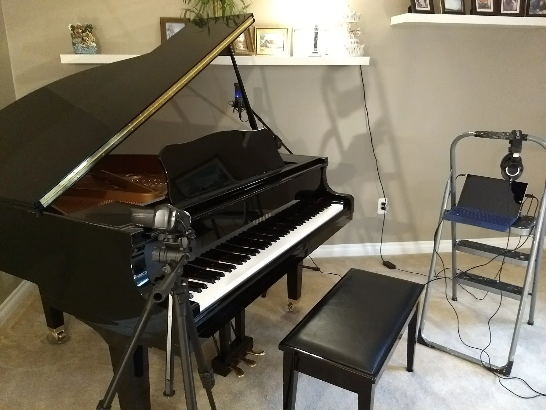

Here's a pic:
Yep, get the mic away from that wall. The shelf probably isn't helping either.
Maybe turn the piano's left side parallel to the wall on the left so the mic has more space. Also try other mic positions.
Looks like a difficult space with a lot of hard surfaces. How does the piano sound where you sit? Maybe try the mic over your shoulder so it's not between a close wall and the hard parts of the piano? If the floor is carpeted I'd even try something down low, though you might get a lot of pedal noise.
You can try EQ on the track, but there's just a lot of room in there.
Good luck.
To record a grand piano well, you need a good room. That's why everyone uses virtual instruments these days.
Indeed - We've been recording pianos for some years now, and just recently discovered one of our recordings we were all positive was the real grand turned out not to be! I thought the recording sounded fine - were there some peaks that were a tiny bit distorted? Needs watching with a USB mic as over level performance often suffers as the gain inside is fixed.
Yeah, with the pic, I'd say you chose the 2nd worst spot in the entire room to put the mic. I'm actually surprised it sounds as good as it does, considering.
12' square room - assuming an 8' ceiling - You're in an epic acoustic nightmare.
I would put the mic 4.5' from one wall 4' from another and move the piano until the mic is in position. Short-stick it - You're not going to get a decent room sound no matter what (short of ripping all the drywall down). So go for the best direct sound you can. If that's a C5 (can't tell by photo) try going just beyond the 3rd port (the first in the 3-set) just over the rim, pointed towards middle C about halfway up the strings. That should give you a reasonable relationship between hammers & soundboard. Tip up for more hammer, down for more board. Sideways on the mic if not obvious. If a bit muddy, more into or out of the cavity.
The room is still going to be an issue - And this is a more "live jazz ensemble" single mic method - but considering the space, it's probably more of what you're looking for.
The square room comment says it all. The piano would not sound good in that room even before the mic was placed.

All I know is it's not a C5, it's GBK something... I'll have a go at moving things around for a second go at it, thanks all for the good advice!
