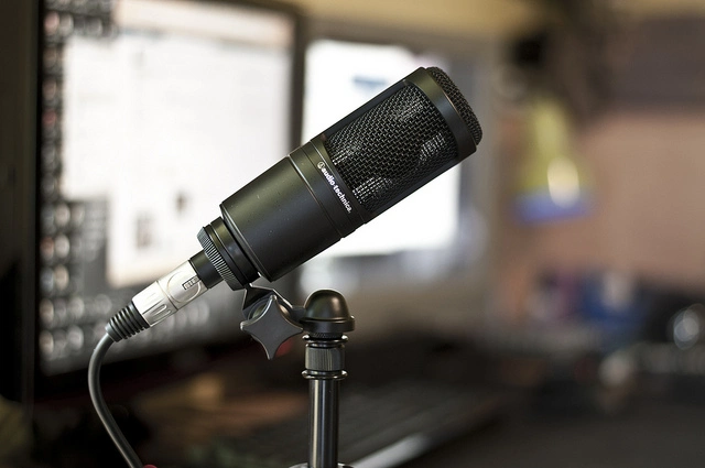

This mic is also very easy to use backwards. I've done it!
It's not just AT2020s. I'd say that the majority of LDC mics are very easy to get the wrong way around, especially if you're in a hurry.
Wait . . . how do you use a mic backwards?
The AT2020 is a side-address mic with a cardioid (directional) pick up pattern. Therefore only one side of the mic picks up properly. The other side has almost no pickup at all (you'll be getting mainly echoes off the wall behind the mic. Similarly, the end of the mic is where the pick up pattern is rolling off so you'll get some sound but it'll sound very "off mic".
The thing is, a good many side address LDC microphones are very lax about marking which side of the mic is active and which is the null. AT make this one even worse by putting a grill across the top so some people assume it's an end address mic.
Or perhaps into the end like an RE-20?
Would someone(noob) try to use the stand mounted mic shown below as an 'end fired' mic if not familiar with a condenser. Speak into the top grill :)
