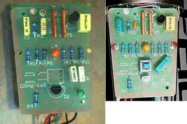

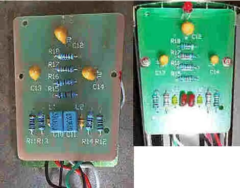

For those who maybe interested, these are the pcb's from the HA101 and a Cascade M20, courtesy of bunyip and Flatpicker.
I will leave it up to the individual to decide whether to slight differences between them constitute a modification which justifies both the claims and inflated price. Remeber that $600 Aust is approx equal to $400US.

BTW.........the Cascade pcb is the larger of the images and the roll off switch is mounted on the mic casing of the Cascade, hence it's abscence from the pcb.
:cool:
Unless I'm missing something they pulled 2 capacitors and changed 'cap type' [and perhaps value] on 4 more... could make a difference... might even make a $400 difference [not bloody likely, but it might]
Yep, and even then I can't be sure that there are that many changes. Thing is, that there is no guarantee that cap types don't change during production, depending on what is available at the time.

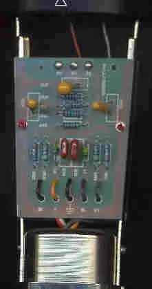

Just for the hell of it, here is one of the pcb's from an Apex 430............and going on appearances in the full size pic, it is a much better quality build pcb.
Fletcher, frankly I don't know why you are even bothering with these guys.
:cool:

It looks like the M20’s worth more as far as parts go. The HA-101 has one cap in place of C6 and C7 (“we don’t need no stinkin’ low-cut switch, so let’s save $0.20 per mic!” Funny though they left the switch on the board. I guess it cost too much to have it removed…), C8 is missing (we don’t need no stinkin’ filter cap on the capsule’s polarization voltage, so let’s save $0.39 per mic!). For C3 they’re using a mono cap where the M20 has a film cap. If they were using a type COG mono, it would maybe outclass the film cap, but I’ll bet it’s the cheapo Z5U version which is cheaper than the film… C10 and C11 appear to be multi-layer ceramic caps which may or may not be a slight improvement over the M20’s film caps, again depending on the type. That’s about all I see which amounts to what… about an hour's worth of R&D time?
$699US – What a Rip!!!! :mad:
Oh… it must have a Neumann Capsule and custom transformer!:eek: :D
