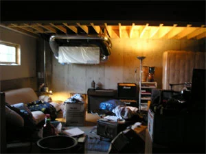

I have the VTB-1, as well as other preamps that sound similar to the DMP3.
They sound different, but they dont really blow away anything, least of all the ART. The ART is a pretty useful box; tracking at a speed beyond my skill level, and the noisy HVAC heat recovery system that sits in the basement where i currently track have way more to do with the sound than a cheap preamp! Just look at the size of the freaking thing!
