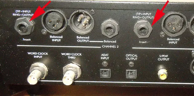

Here's an image showing where I've been plugging in on the back ...
I think I'll try the Hi-Z approach first. (Doesn't involve buying more gear.) That's on the front of the unit, and I've had complete tunnel vision on all the input/output stuff in back. Thanks, and I'll let you know what the results are!

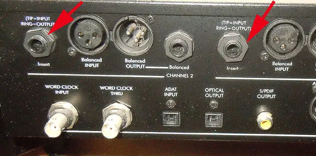

There's you problem. That insert jack is not a proper instrument input. Either use the "high Z in" on the front or get a DI box.
The insert jacks are for plugging in an outboard effect box.
Yep, they are after the input gain control in the signal path. Even if you did get signal the tone might be off due to being lower impedance than an instrument input. The high Z input is made for guitar pickups.
Another case of a newbie colliding with the furniture. Thanks for your patience.
