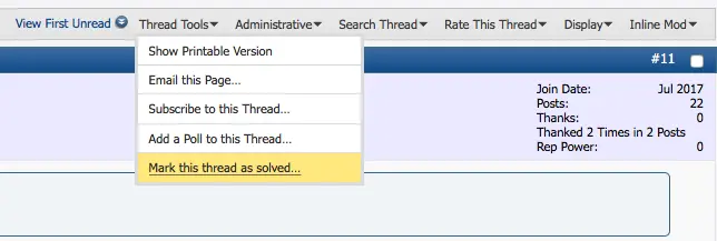

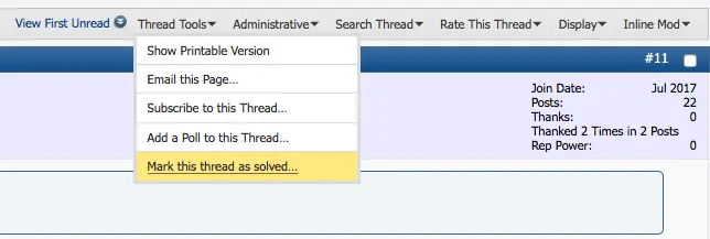

Yeah, it's a little silly. You have the option of marking [SOLVED] when you create a thread, so I guess that's where you saw it.
Once posted, the option is in 'thread tools' up at the top right, as pictured below.
The word and brackets don't become a part of the title - It's an additional tag.
Cool I get it now. I assumed and was looking for it to be on a 'new post to the thread (or advanced) page.
And naturally it's not available if you aren't the one who started the thread.
That's a nice feature we should see used more.
Of course, we could always just type " Solved. Thanks" !
