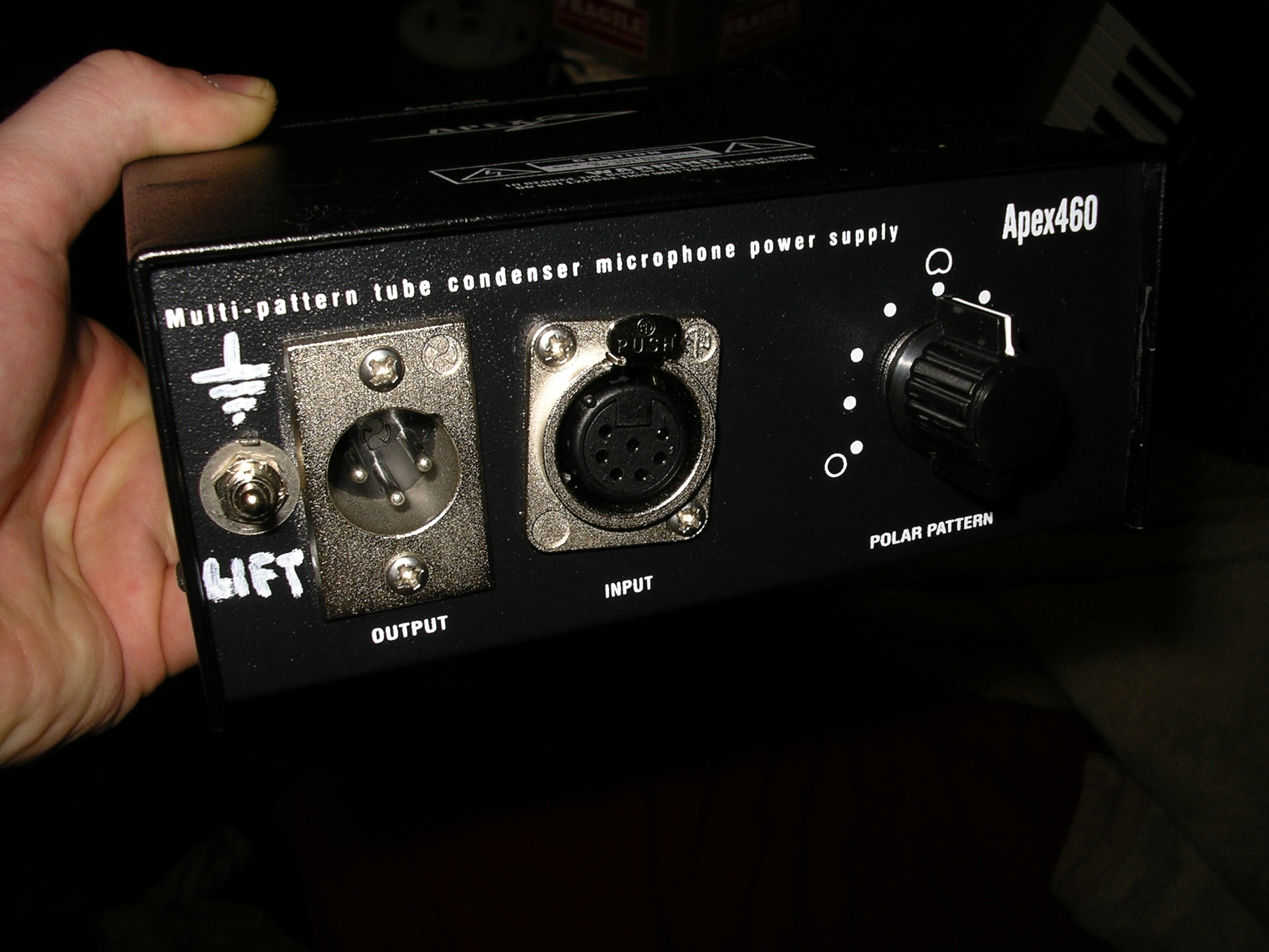

Here's a picture of one of my power supplies with the updated Neutrik jack. The holes didn't line up with the old jack, so it's slanted a bit. Perfectly secure, however.
I also have spent the past evening and morning hunting down a faint 60 cycle hum that was driving me nuts. It turns out that when I lift the ground to pin 1 of the XLR on ONE only when BOTH are plugged in, that kills the hum and everything is perfectly silent. It also has to be one in particular, and not the other. I wish I understood why, but, at least there's a solution. Lifting the ground on both of them makes the buzz worse.
So anyway, both of my power supplies now also have a ground lift switch for the XLR output connector. Maybe someone else might find this handy? It was a very quiet buzz, maybe -65 or -70 dB, but I could hear it with the gain cranked up a lot on my preamps or speaker volume.
