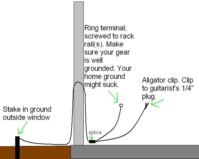

Make yourself a "technical ground".
Though to have full implimentation you'd have to isolate your home's ground away from all outlets feeding your studio gear (and the guitar amp).
Just doing this will help lower your ground resistance, thought it won't isolate your home ground clicks and pops. Anyways, that's not your issue.
Use at very least #10ga wire leading into the house (few bucks).
And pound a 5/8" rod 1ft into the ground (few more bucks).

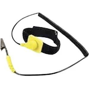

Then get a wrist ground strap. Only a couple bucks at any computer parts store. Have the guitarist wear the wrist strap, and clip the aligator clip to his 1/4" connector (along with the one from the technical ground).
If it is still doing it, he probably has really bad/missing ground in the guitar or in the amp.
Grand total cost, maybe $10-$20 if you don't already have most of this stuff.
