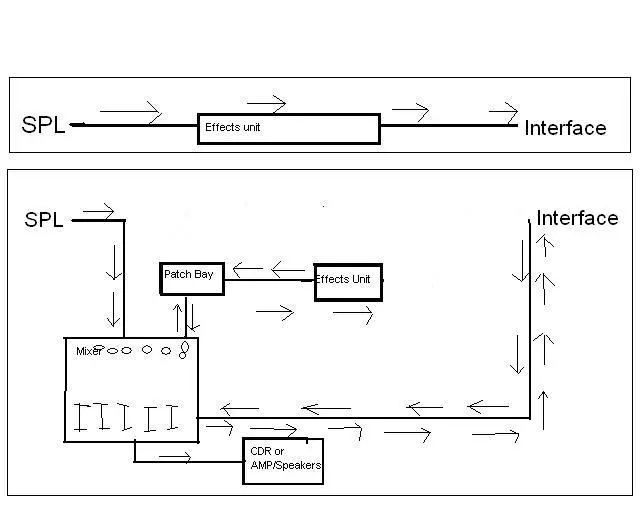

this is the idea i'm leanin toward though...i would then be able to use a loop in the mixer to apply hardware fx right?
Well, in the studio, the TDM or HD systems (usually 3-4 systems) are say connected channel to channel to the patch bay to the SSL console (unless the studio connects mic to mic cable directly to a digital console which has the ability to route the signal anywhere you want first, like a patch bay but internal). Which when we start patching side chains, we are able to do it. When you have mic to interface, or whatever, using something like reverb as outboard gear is hard because Reverb's are used as sidechaining, and never inline. Inline being break the signal right at a certain point, route it to the reverb effects unit, and then into your interface, which is the incorrect way to patch in a reverbs unit. Also, using the mixer alongside a multi io interface, your able to send the wet reverb to another seperate channel, maybe panning the reverb out, instead of it sticking to the audio. I assume you know why you can't inline reverb's, or delays, or anything that suppose to be used in side chaining...
I attached a VERY simple picture of the signal chain. Which doesn't include EVERYTHING like the patch bay, mic, mic cable, floor channel, A/D converters, AA, etc... but It does show the signal chain of having a mixer verses not having a mixer.. When it hits the Mixer, your able to send the wet signal from say the effects unit along with the dry signal (which remains separate) to the interface via mixer. Basically hitting the patchbay/effects unit before the mixer sends out to the interface where it is tracked, and then playback would occur as seen, interface to mixer to power amp to speakers. The other method, just using the interface, you wouldn't be able to side chain, and whatever sound you record that goes inline into the effects unit, is changed there, with no turning back when it hits the interface. If it doesn't clear up anything for you, I can draw a better picture lol
