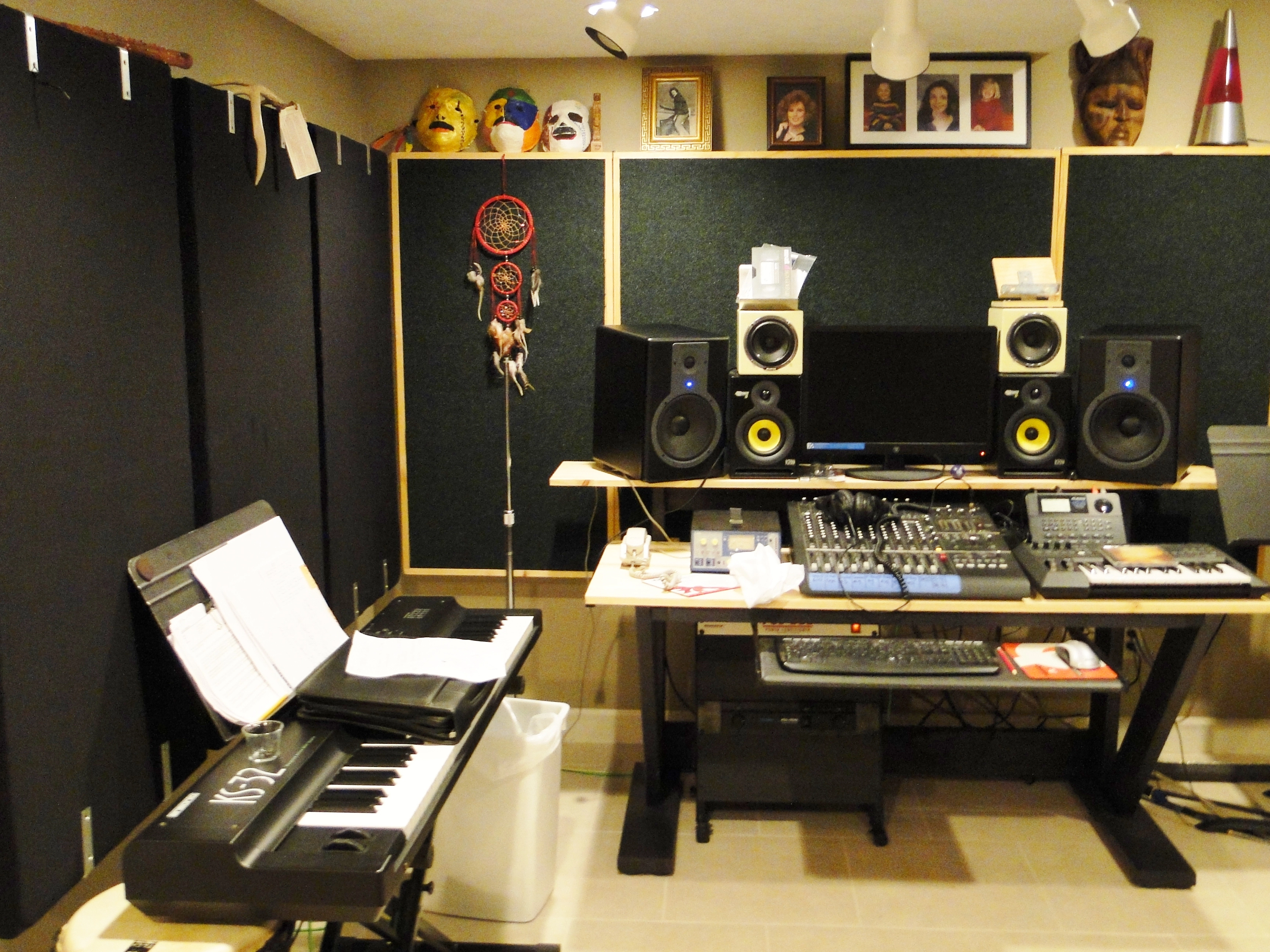

So I'm making my studio now, all is going well. Does anyone have any suggestions or alterations?
My 27" iMac will sit here fairly far back, while two KRK rokit 5's are wall mounted w/ isolation pads
Should I add two wholes to my desk to put stands through for the KRK's for more support/less resonating?
Thanks
Thanks
There are manufacturers of acoustical foam, the problem is that it is not the solution for all problems as some people think. I do have some acoustic foam in the studio but it is only to tame some top end around my drum area at head (cymbal) hight, and I have a little on a wall near where I usually record guitar cabs as there was a little high end slap-back there. But this is only to fine tune the highs a little and only after the bass trapping, midband absorbers and ceiling clouds are installed. My control room has no foam just home made acoustic panels. Typically foam only attacks the highs and if you take away all the highs you are left with muddy mids and lows.
But it looks cool!
