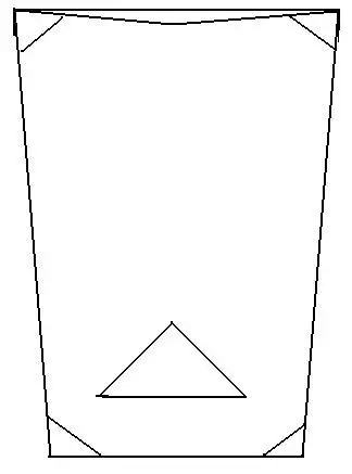

Yeah you kind of answered your own question. Standing waves are bad news to serious audio enthusiasts. If I were you, I'd angle the walls. This way you won't have to heavily treat the rectangular room. Try something like this. I just did a quick sketch. Dimensions can be found at Ethan Winer's website.

Of course they'd need to look more like a John Sayers designed space but if you're looking for a minimalist design to help keep the waves at bay, this one would do OK. You'll still have to treat the interior some, but not as much I wouldn't think. It's just a sketch BTW. Rod is right though, if you got the money and can make it symmetrical, do that instead.

Thanks everyone for the tips! Chris's rough layout is exactly what I'm thinking about. it might make it a little bit more cramped, but doable.
Correct me if I'm wrong: the triangles at the top two corners are bass traps, yes? What are the triangles at the bottom (mixing) end?
I have a follow-up question. If I angle the walls as Chris suggests, are the angles of each wall critical? Or as long as I make it symetrical, is any degree of angle o.k.?
