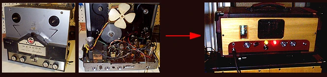

the rest of that Webcor is just junk? Use the amps and toss the rest into a misc. parts box? Is that it?
BTW, that amp DIY thing looks awesome! :eek: ;)

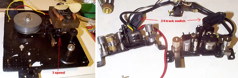

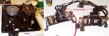

Dave, other parts are pretty cool stuff too. Useful? Hard to tell. I am attaching a photo here. You see that mighty motor got two wires. plug it into the wall and it spins damn well :D That system is straight forward. There's a mechanical switch there, moves the belt while it spins and shifts it ... three speed spinner, that is. I actually am thinking about maybe building some sort of rotary-drum/speaker cab thing, but I am not sure if that motor is up to the task yet.
The heads from those webcors are pretty fancy, I'd say. They are actually half-track heads and they have switch that shifts the head a bit up.down so it can work as two-track or four track. It would be cool to bild a some sort of dedicated tube-driven half-track format delay machine, but, man, I am not sure that I'm up to that task. It's doable, but will be hard and will cost too... so I don't think I'll get to it, from practical point.

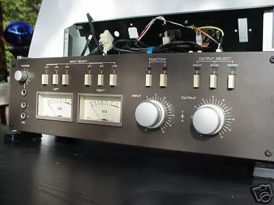

Did'ya see the Tascam 32 preamp section on Ebay today?
I guess you missed it! And only $25!
:eek: ;)
I thought about bidding on that 32-preamp for a while, but...
Naaaaaaaaaahhhhhhhh!!!
I have too much fixit gear already, and a fully intact Tascam 32! :eek: ;)
huh, Dave, that looks like a nice gadget to me :D
I'm not sure what it's good for as is. Parts are cool always. To make a two-channel preamp out of it? - maybe. I've seen similar auction for otari mx5050 two-tracker piece. I've built another special pice of gear some time ago, based mostly on parts of a disfunctional jvc cassette deck, but the main purpose of it is - auto-transformer step-attenuator, also can function as preamp/level control/VU-metering with peak-metering. It looks cool in action :D . Here's the link to the page of the project , (not much details there). Direct link to chart/photos jpg.
