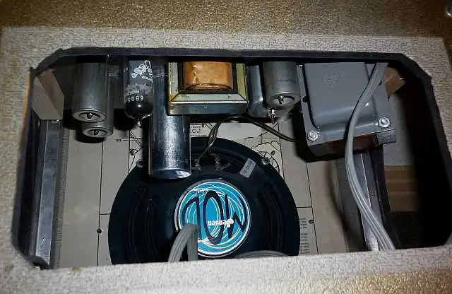

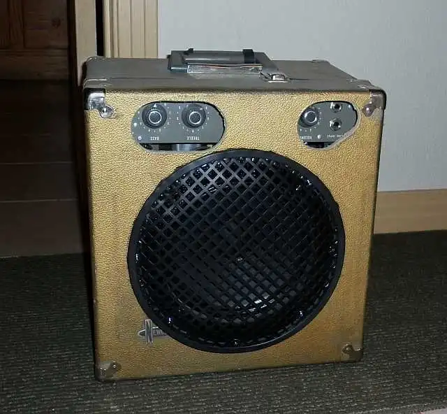

Here's an example of what's possible for less than twenty bucks. This is a Newcomb R-R from the early 60's. 2X 12Ax7, 6BQ5, 6X4. James tonestack. I've got it wired as a two channel with a guitar input, and a high z mic input for harp. It's an absolute little f'kn firebreather. Total investment $16. $10 for the tape deck, $5 for the used speaker, and $1 for the grill. I did use a couple pots out of my parts bucket, and a few other components, but I'm sure I still came in under $20. Old gear like this can also be a treasure trove of vintage tubes. In this one the 6BQ5 was a Bugle Boy, and the 12AX7's were IEC/Mullard.:eek:

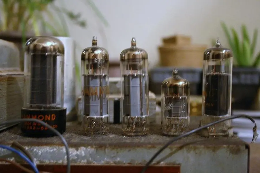

check this score, at least i think its a score so far... the tube amp from a hammond organ... 3 6b5q's, 12ax7, and a 5Y3 recto... you think this is a decent chassis for making-modding into a guitar amp? the only corrosoin is on the exterior, and on the exterior of the big output transformer... the tube pots seem to be pretty good.
there's two tiny lightbulbs in it too.

Very cool. While I'd hate to butcher up a Hammond amp (I have a Hammond), I bet you could cobble together a great amp around those trannies.
You can cobble a great amp, but then you'd need to know theory and some 'advanced' theory about layout and shielding. I still say a kit is a great place to start. Expensive, but consider what college would cost. This is better, and trust me; you won't be selling your 'books' even after you flunk with a 1.0 average.
Hell that thing's doing nobody any good the shape that its in. Judging from the corrosion the organ that it came out of is long gone. If the iron's good that could become a nice 18w. That's definitely not a project for beginners though.
Words of wisdom, ranjam speaks the truth here. If you want to play around with an old amp, you're much better off if you start with something that's working.
Triode Electronics has good kit prices too. Triode Electronics Tube Amp Kits Transformers Tubes Dynaco Upgrades and Parts
I've never been one for easy! I was thinking of swaping it all out except for the tubes, and the sockets, it probably needs a new cap can too... If y'all got any suggested reading, I'd appreciate it. :)
and yeah aside from the outside corrosion, the rest of it seems utterly immaculate.
it either sat collecting dust before my friend let it collect dust, or it well was well taken care of.
oh, a 12ax7 can be put into a el84 socket and wired properly right?
