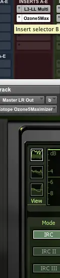

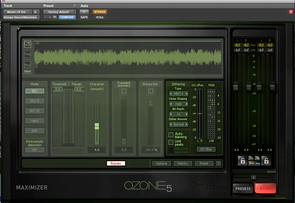

Also, I've attached an image to the maximizer plugin. As you can see, I have the "BYPASS" button turned on. Does this mean that ONLY the Mbit+ dither is turned on and everything else in the plugin is turned off? Or does pressing bypass turn off the dither as well? (My goal is to only use the mbit+ to dither)

To clarify, bypassing on that plugin doesn't effect the dither? In other words, I'd have to choose "none" under the dither settings in order to not use it, or not have the plug in on an insert?
Right....you should be able to still use the limiter portion without any dither...though there may be some limiter presets that automatically turn on the dither, so just check the dither section.

I'm worried that by pressing the bypass button, it is turning off the entire plugin (including dither) because the plugin is greyed out as seen below:
It looks to me from the image I posted a few posts back that bypassing won't turn off the dither as it didn't grey out that area, but I just want to make sure.

I see three Bypass buttons on that GUI....which one is for what is up to you to find out.

Thank you for your manual suggestion, however I went through the manual and couldn't find out if the bypass also bypasses the dither section, or not.
The 3 bypasses all do the same thing. Each one shuts off the exact same stuff when enabled.
Hitting that bypass button turns off EVERY function of the Ozone plug-in. Dither or ANYTHING else that it offers. If the plugin box looks blue (as it does in your latest photos), then it is like the plug-in isn't even there. If it's white (as it is in the second photo), then it's doing it's dithering.
