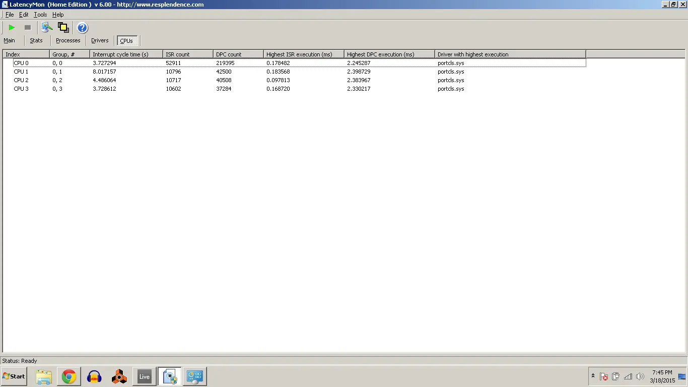

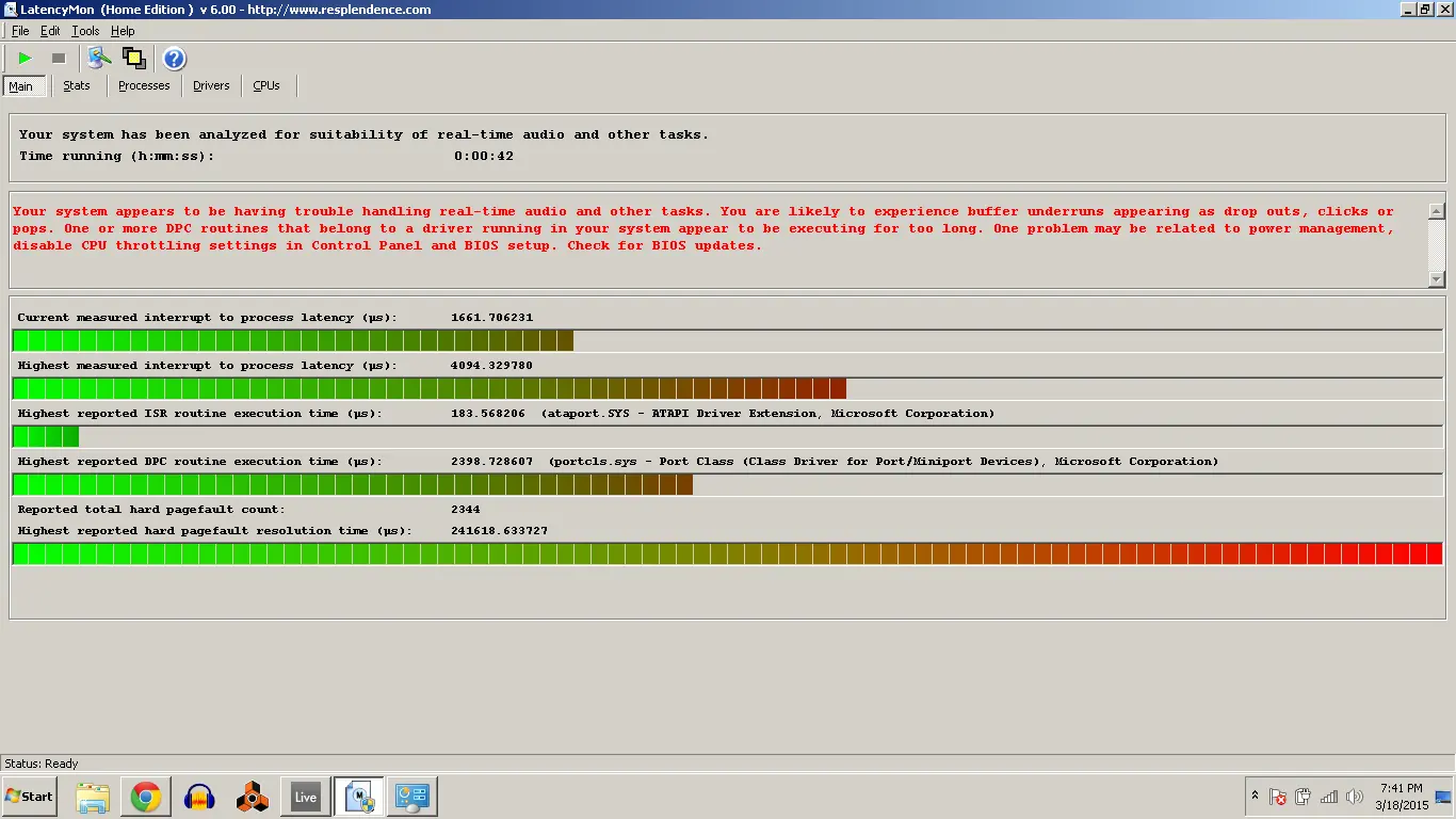

I'm not showing any maxing out in my Resource Monitor. From my standpoint, it doesn't seem to be CPU maxing out, hard drive not keeping up reading/writing, USB hub and/or throughput insufficiency. I'm pretty adept, but not really advanced with this kind of thing, so maybe it is one of these things? Anyway:

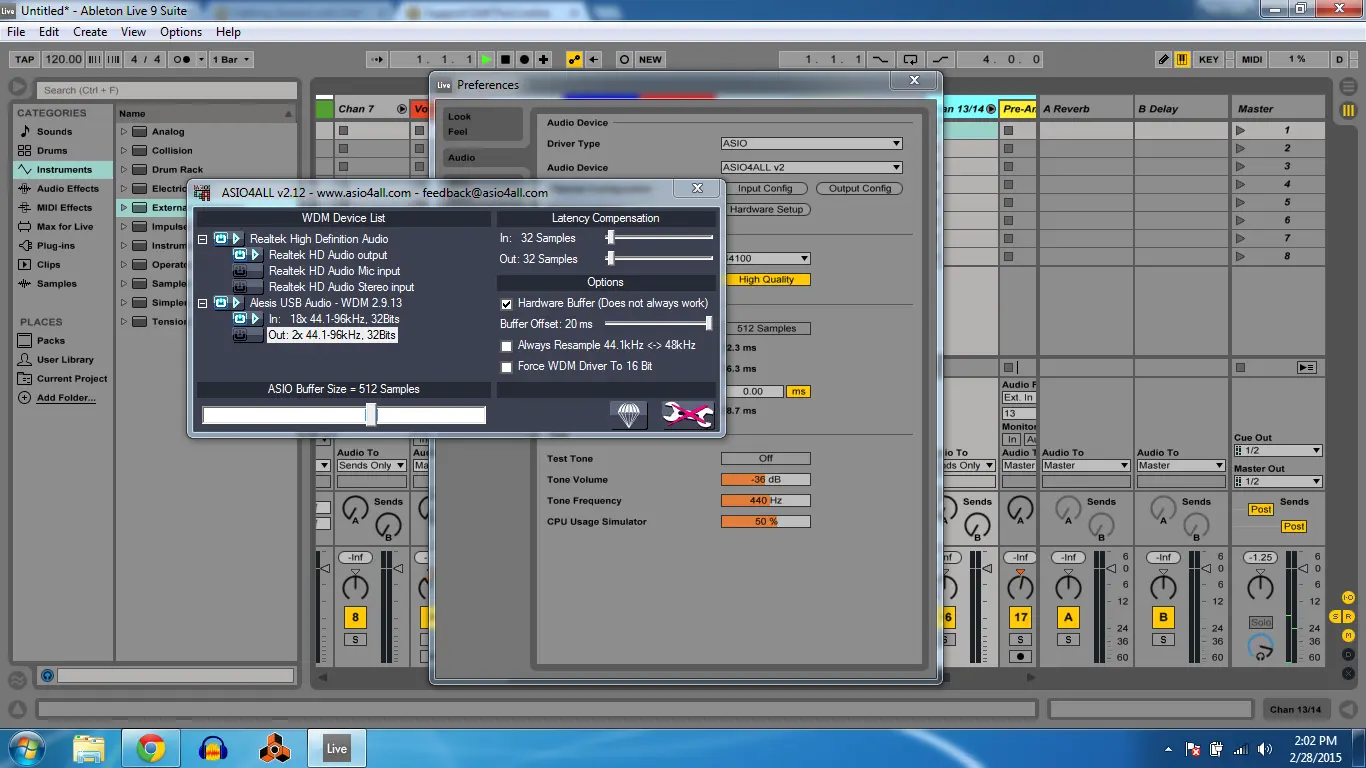

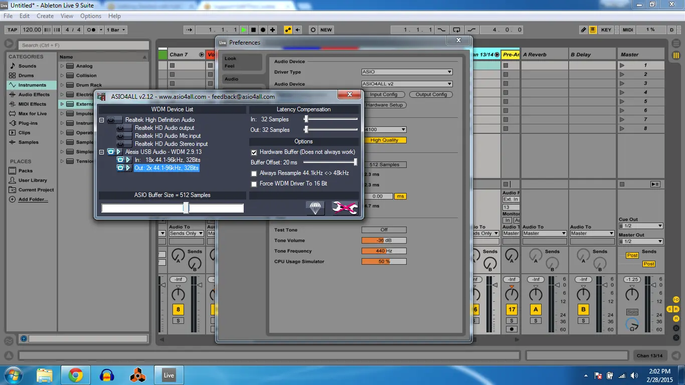

1) I've tried running In / Out through the Multimix. The result is usually latency of about 1.5s.
Video of the symptoms:
[video]https://drive.google.com/file/d/0BzmgALUm4SYeUF80NXFpbURieW8/view?usp=sharing[/video]
2) I've tried running In from the Multimix and Out via computer sound card. 1/8" Headphone out from computer into Ch 15/16 of Multimix, and use that channel to monitor recordings from Ableton. The result is usually a clean signal, but in a matter of seconds/maybe 1 minute, the sound starts to become garbled and unusable. Resetting ASIO4all or changing any devices' buffer amount cleans up the signal, but then it becomes garbled again.
