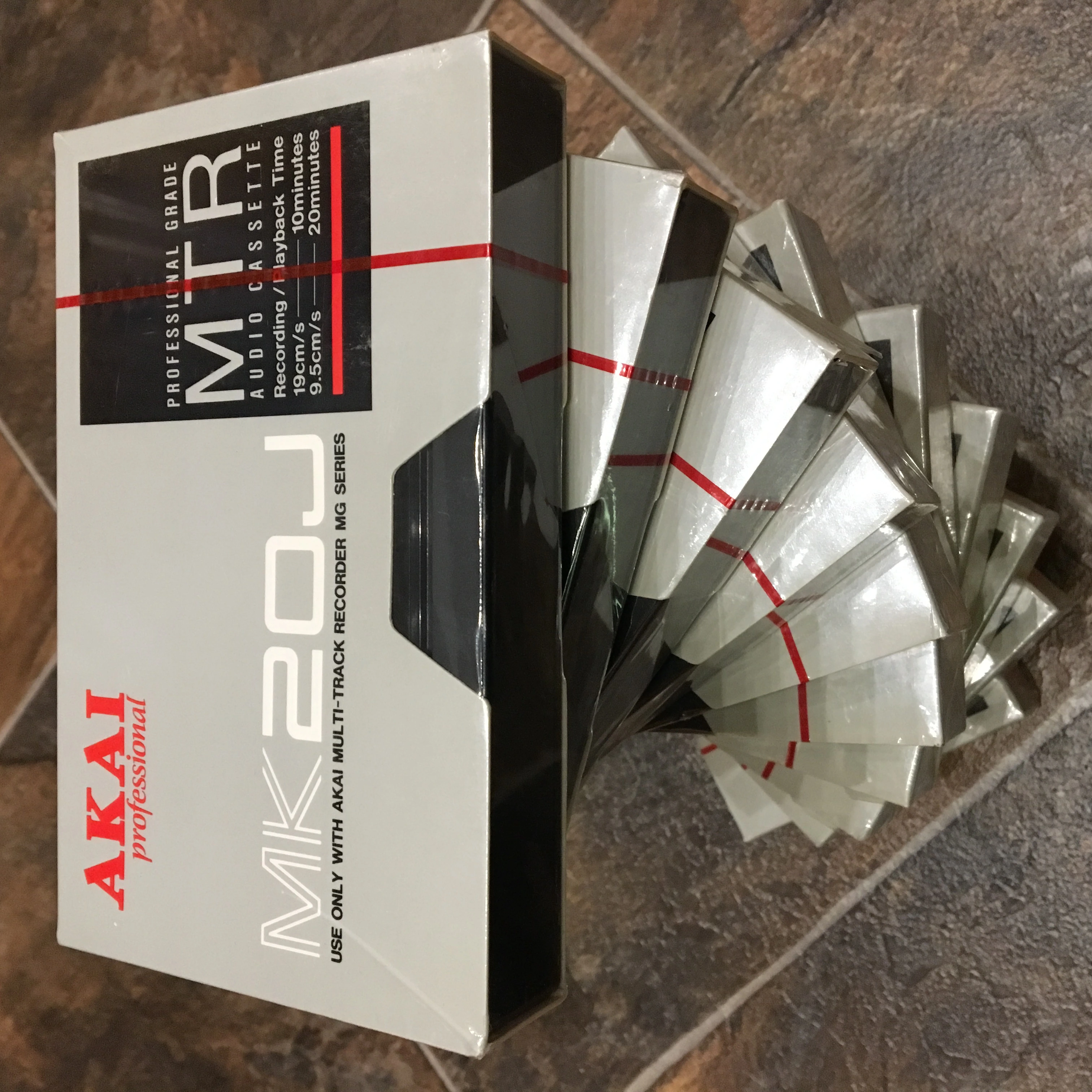

I got 'em...and they're bonafide...10 NOS sealed in plastic MK20J tapes for the MG1212/MG1214/MG14D machines. Will I ever use these? I have no idea...but...they are relatively rare oddities of the vintage analog multitrack world, and they're in good hands.
