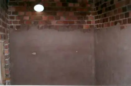

Hey guys, it's been a while since my last post here... and I have to say that if studio is up now, it's all because of you guys.
I'll pos the pics here.
My studio is a 25 sq. meters building where I divided it in 11 sq. meters for the CR and 13 sq. meters for the Live room (aprox.).

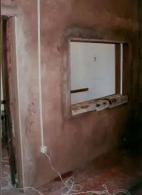

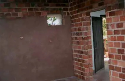

The live room have a box inside the box, or double brick walls... the CR window has 1 10mm glass and one 12mm glass mounted on neopreme btw the glass and the wood...
The doors to the LR are 2 solid wood doors with a 1/2inch rockwool panel mounted on a 10mm plywood board on each of those doors...

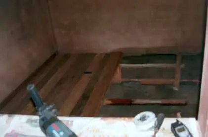

The floor on the Live Room is a almost float... almost...
Everything I used to build those rooms I learned from yall and John helped with the design of the rooms... simple stuff... I just couldn't think about it :).
Thanks yall!

Looks like you're on the right track my friend.

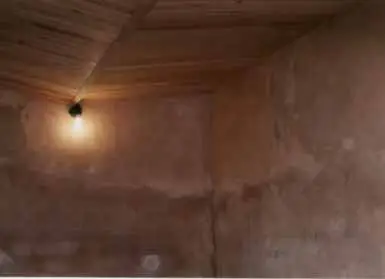

I don't know if I'm doing it right... but is there a way to post more than one pic per reply? :)
