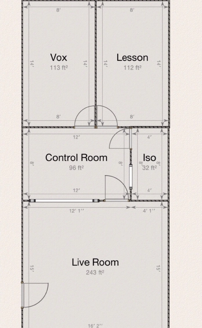

Here is the layout of the space I am using.

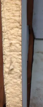

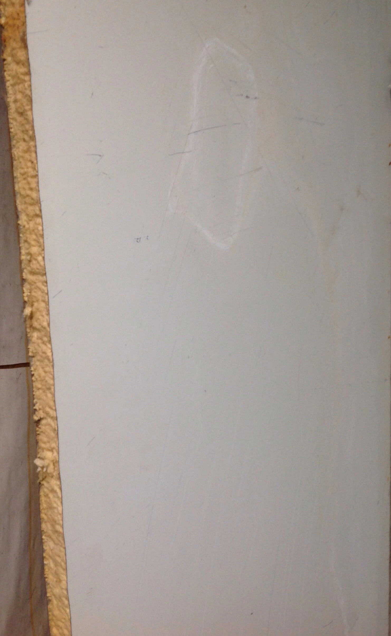

My question relates to the vocal room. I have a few salvage items that I have repurposed in this build. Here is one item
What these are, are metal panels with 2 inch foam sandwiched between two 1/32 thick metal plates. This was used in between the wood framing to add mass. On top of that is 1/2 inch plywood.

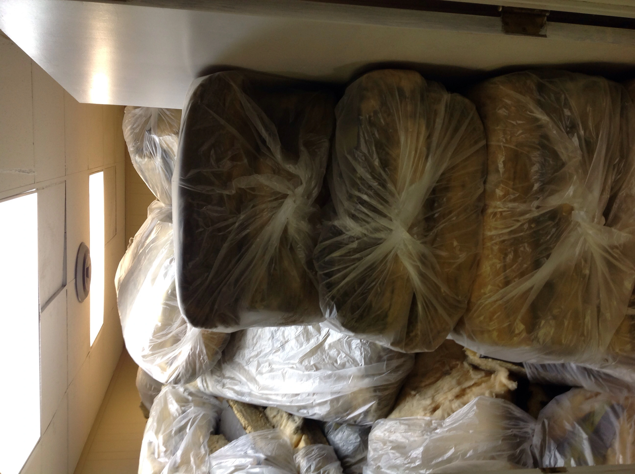

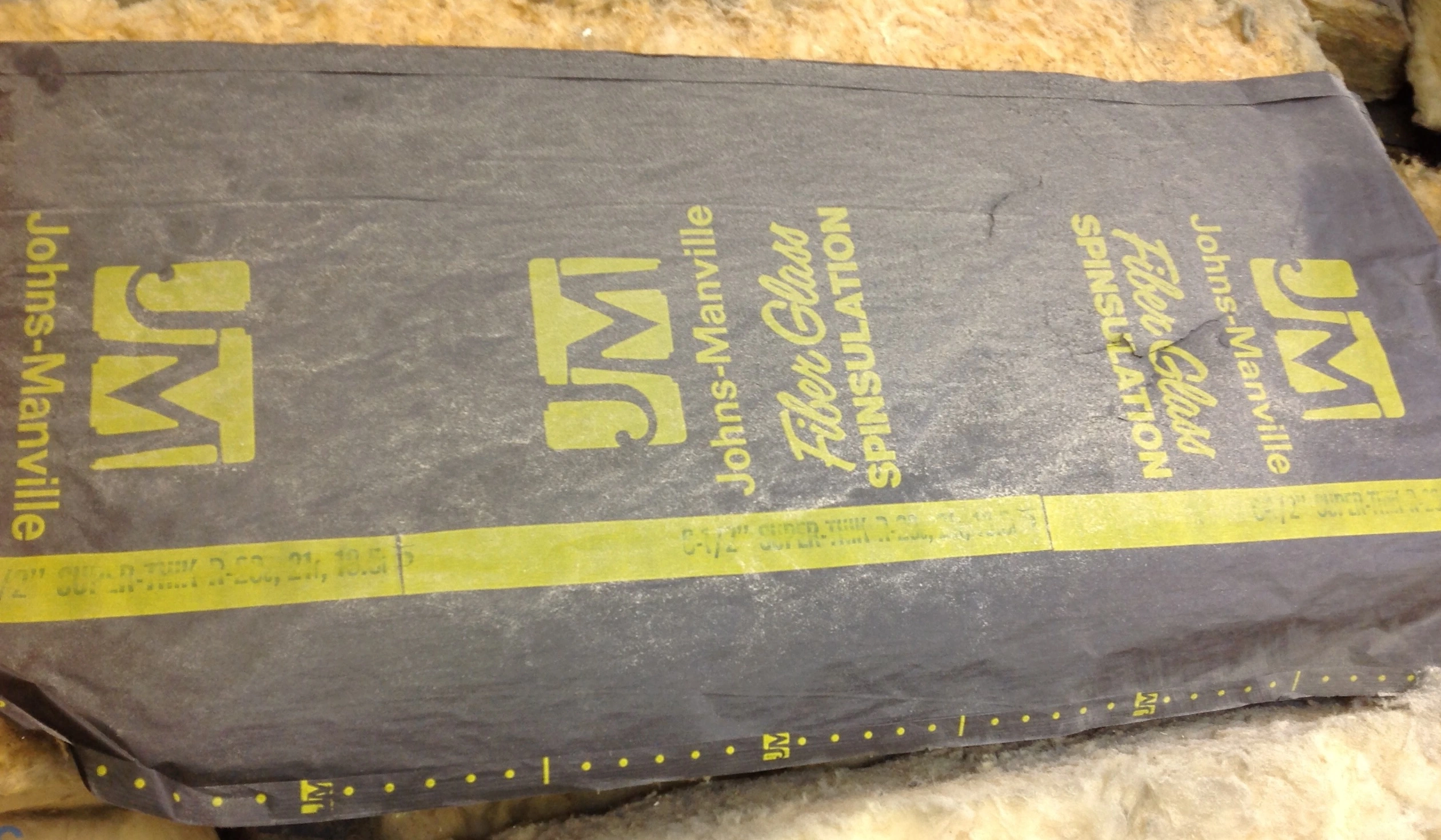

I also have a whole lot of this left over
Its Johns-Manville r28 2x4 and 6 in thick
So here is the question.....
I want to use the insulation for bass traps and could go the traditional route and build out the corners but how well would it work if I just built the whole back wall as a large bass trap. Ceiling to floor 8 ft long bass trap?
Do you think its over kill or would it be a better bass trap? I am open for suggestions and appriciate any input you guys may have.

8" fluffy is 2X as good as 4" OC703 at lower frequencies. But that does not address corner superchunks.
