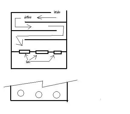

I really like the iso box and rack setup. I'd like to see some close ups of the box where the fans are etc. I can't picture what you mean by baffles when you refer to the inflow and outflow vents.

Here's a rough sketch to show you what I mean by a baffled air intake. Basically this system is under the rack enclosure part of the box. The air flows in through an opening at the bottom rear of the box. The baffles are made of 3/4" MDF which basically makes a "tunnel system" for the air to flow in from the back to the fans which are drawing it in from the front. The more baffles you use, the further the sound is restricted from escaping out the port in the back. I lined the "tunnels" with acoustic foam; not sure how much additional help this really was, but I had the foam so I did it for good measure. Once the air makes it through the fans, it is forced upward through a slot into the main portion of the box. The cool air is then drawn into the front of the computers and hot air is ejected out the back of the computers. The hot air is drawn into a box by three more fans at the top rear of the iso-box, then directed out into a similar (but differently shaped) baffling system attached to the top left rear of the box. This outflow system also serves as a routing path for the numerous cables going into and out of the box.
Once I finish the desk and perfect the fan mounting system I will put together a detailed article with more pictures and diagrams and post a link to it here in the forum.
