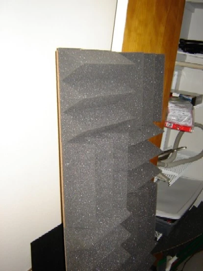

Hopefully the picture thingy works. I moved not too long ago and I haven't installed the panels yet

Picostudios - if you have a flick through the manual for those Alesis monitors (available online) you'll find that the tweeters are supposed to on the INSIDES rather than the outsides as they are at the moment. The full reasons are explained in the manual ... so swap 'em over!!! Nice foam arrangements, by the way. :)
