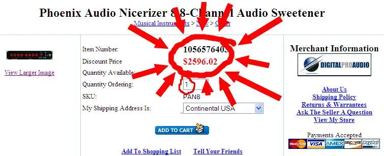

Yes, it does have ADAT and I want more than 8 outputs because I can d further seperation for thr 16 NIcerizer I will be purchasing.

Sloan said:
Audio Nizerizer?
wtf, that even sounds like a ripoff.
But dude, it will "sweeten" the sound, and it's only $2,600! :eek:
Seriously, dzara 4, you do NOT need one of these.
Take that $2,600 and buy some gear that will help you actually record audio. And as a general rule of thumb, once you get your music into the digital realm, don't go back to analog, unless you have quality converters.

dzara 4 said:
Why do u think I would be wasting money? :)
Because if you are new to recording, neither you nor the "Nicerizer" have the chops to do what you're imagining in your head that they will do.
Anything that claims to "sweeten", "excite" or "finalize" will not make a bad mix sound good. The irony to such devices is that the less a mix needs such devices, the more benefit such devices will provide. Think of it like cooking; if you are still working on making the perfect batch of rice, it's probably a waste for you to go out and buy a jar of saffron for $50/oz because your rice still isn't going to be very good, and could actually become poisonous if you try to use too much saffron to "fix" it. If, however, you are a great cook who can already make a killer paella, a little bit of saffron will actually make it even better.
Save your money instead for good acoustic treatment or an A-list mic preamp/converter signal chain, or stocks in Canadian oil sands extraction companies. Just about anything other than anything whose name ends in "-izer."

As far as the nicerizer, that might be worth it or not. That's awfully expensive for what looks like a basic summing box. I use analog summing, but the unit I have is called the X.Sum and is made by Speck Electronics. You might want to take a look at it, as it has a nice set of features and sounds great. It is also less expensive (around $1,500 street) than the nicerizer, which means you'd have some budget left over for the eight channel converter.
