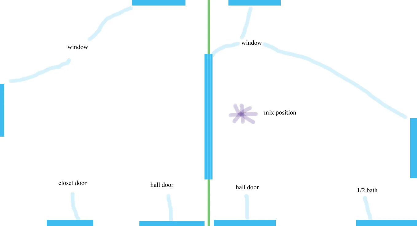

here's the scoop
i have: 36 of these batts
1260 2" (51mm) A 6.0 pcf (96 kg/m3) 0.25 0.85 1.15 1.10 1.04 1.06 1.05
and these 2 rooms to put them in
i was thinking of starting with 4" thickness (floor to ceiling) in all 5 trappable corners, which leaves me with 16 batts to play with to make these rooms suck less.
both rooms are 11.6*12.6 feet. cellings are 8' (floors are carpet, but that may change when i get more money :rolleyes: )
thanks for any help!
p.s. this 1260 stuff is like 60 cents a square foot!
