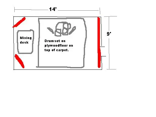

How about Balance? Before I was thinking of 2 traps 2x4 in the front corners and then 2 traps across the other side up at the ceiling. Basically 1 long trap. I'm attaching a quick sketch... hope it works. Traps are in Red
What if I did the Super Chunk w/ 1 in the top left corner and 1 in the bottom right? Then I was thinking I could either do the long one across the ceiling (it takes away no floor space) or have 2 of the 2x4 panels that I can remove if I need to. Or does the trapping in the room have to be balanced to be effective?
Any ideas?

I've never thought of building a long panel like the one you illustrated. Perhaps an expert can comment on it?
(Gah... I'm still itching... dammit, I showered three times already...)
I'm pretty sure that I read that if one corner is bass trapped, then one on the opposite side of the wall away from it would not need one. I think you would be fine with super chunks on the mixing desk wall only, and a cloud would help, it is also good to get the back wall as dead as possible, and make sure to set up a reflection free zone if possible. Your room is basically the same layout as my first studio build, but the instruments weren't tracked in it. My room was 11' x 9'.

I have another question. For corner bass trap PANELS (NOT super chunks), is it pointless if the panel doesn't cover floor to ceiling?
For example, in my control room, if I make a 2' x 4' corner bass trap panel and mount it as high as my monitors. Are there huge disadvantages for not making the panel as high as my ceiling?

Nash,
Floor to ceiling is usually better because you get more surface area and you get both tri-corners. However, any corner coverage is going to be a help in almost all rooms. It's not at all a waste.
Bryan
