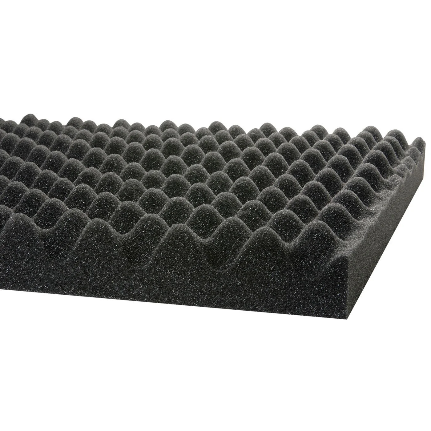

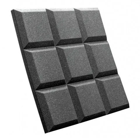

Also, I was a bit confused about the kind of foam and density need for absorption of mid/highs. Internet research tells me that a 2"- 4" open cell PU foam with a density of around 24 - 30kg/m3 is a good absorber (the choice again depends on the room and the walls).
But the egg crate foam absorption sheets look quiet different (a little more porous) egg crate foam.webp as compared to how the foam Pyramid, wedged or grid foam panels look like(much more rigid, less porous).grid panel foam.webp
My confusion was - Are they both open cell PU foams of different densities? Or are they different types of foams with different densities? Or are they same? I was comparing what I understand by the 2 images attached.
Can someone help me with my question? Dont want to go blank to a foam store.

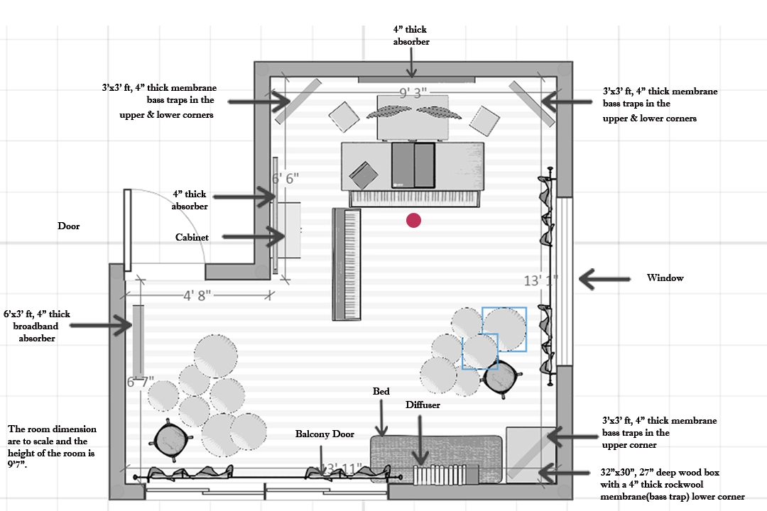

[MENTION=39487]mjbphotos[/MENTION] ok you pushed me to finally make a diagram. I have attached it below. The kits seem a little out of proportion in the diagram, sorry for that. The one on the left is an acoustic kit and on the right is a basic V-drums set, which is pretty compact. I keep it there so as to connect it to the mixer with a not too long midi cable. The floor is two carpets put together and the window and the balcony door have thick curtains for now. I was definitely planning to treat the ceiling cloud, but do you think I should ditch foam completely, and only look at rockwool as an absorber whenever needed?
The 4" absorbers in the diagram is me thinking of putting grid type 4" foam which has more volume than the wedge or eggcrate types. Should I just go for rockwool in those places instead?
Any suggestions about placing those bass traps or the broadband absorber better?
[MENTION=7442]mixsit[/MENTION] i did calculate some important data as to what the room modes will be in this room and was planning to use that broadband and the wooden box trap for the most troublesome frequencies by adjusting its distance from the wall. Would love to hear your advice on the plan. :)

Yes, 4" thick rockwool (OX703, 705 or Roxul AFB is you need to conserve money) for all those panels. You'll find they come in 24"x48" pieces, do design accordingly. If you can build the physical traps yourself, you'll save a lot of money, and some people just wrap the rockwool in cloth, no frames.
There's also Roxul Safe'n'Sound, which is what I used, but it only comes in 48" x 15" (wide) x 3" (depth) batts. It' not "floppy" but I think it needs to be framed for must uses, especially for mounting on a wall. They have a product called Fabrock (might have been Rockboard before, as it seems similar) that is in 2'x4' panels, and slightly denser (e.g., .65 vs .52 for 3" depth vs Safe'n'Sound at 125Hz) that probably is Ok to work with unframed, though mounting on walls is a potential problem, so I'd go ahead and frame it.
You should plan to add a couple "clouds" overhead. You'll definitely want to frame that if it's not rigid, and probably need to for mounting regardless.
I'd think about making the corner traps deeper, like 6" or 8", TBH. (Will you actually have 2 drummers going at once in that room?)
Nice drawing.
P.S. think about heavy "blocking" drapes for the windows & doors.

Oh yes the ceiling and the drapes, will definitely treat the ceiling with a cloud of 2 batts to start off, and a 3 layer curtain I already have and see how the room sounds. Sometimes two drummers might play when my friend comes but that will only be jamming. Although the diagonal corner trap with a face of 3ft is giving me a depth (height of the equilateral triangle formed) of around 19 inches. Guess will have to play around with the depth to catch the problem frequencies better.
