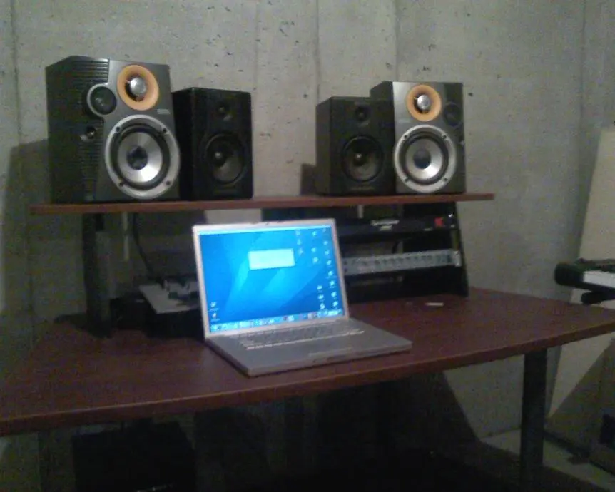

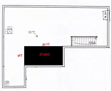

In regards to the room, it's a piece of the basement. I can send you pics but right now there is a bunch of stuff in the way. Basically there is a 9ft length wall and a 20ft length in an "L" shape. Both concrete. The other walls will all be constructed. Concrete floors. And typical stud ceiling. I'll attach the floor plan for now. It was a new build home so I have that on hand. If you still need pics, I can do that in a day or so.
All new HVAC and it is located in the basement. You will see in diagram. There will also be walls built around it creating a room too.(Not for studio use)
The basement is completely underground and I don't have much of an issue isolating from neighbors, but i would like to isolate from the rest of the house as much as possible, within reason, especially the upstairs.
I am planning on recording all types of music. I have connection several genres, but probably rock the most. I would like to have a well rounded situation to accommodate anyone. Just vocalists, or full bands.
Right now i just have some M-audio BX5A monitors. I am looking to upgrade soon though.
My recording system consists of a Macbook Pro and a focusrite sapphire pro 26 interface. I plan on adding as I go but thats for starters. I'm in between recording software right now because I am researching that too, but have used Logic and GB.
I hope this helps you help me. If you need anymore info, let me know. Thank you for your help I really appreciate it.

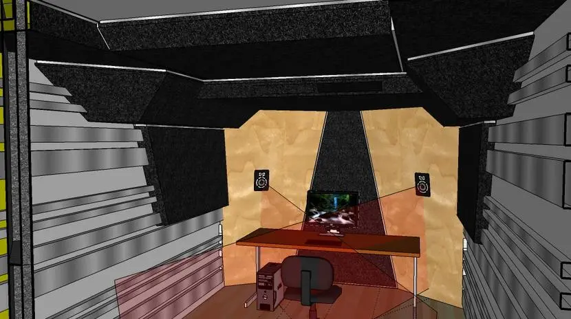

Well, just for fun, here's what the front end of the CR COULD look like.:D(sorry about the size. My editing ap is on the blink.:mad:)
