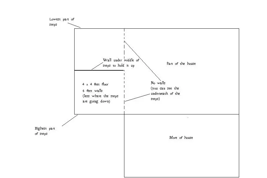

Let me try this again. Imagine a regular house of two floors. There are steps on the side of the house. Instead of the steps just being there, there are bricks below the steps to enclose the space. By this I mean there are walls under step so that you cannot see underneath the steps. Where the steps are attached to the house it opens into the house at the bottom level. Meaning you can get under the steps from inside the house on the bottom but the outside has the brick walls. Presently it's being used as a storage area.
There is 4 x 4 feet floor. Concrete plastered walls, on the inside, 6 feet high. Floor and ceiling are cast in concrete.
The steps are enclosed at the bottom. Above it is exposed to the outside world. The room is closer to the highest part of the steps. So one wall is below the highest step and is 6 feet. The other wall opposite is shorter because the steps are coming down. This wall divdes the space below the steps into two rooms. Now when I say 'rooms' I mean spaces because each space has three walls and where a fourth wall would be is where the steps connect to the house. The wall dividing the spaces is also brick.

I'm not sure, but I think when he describes a wall on the back of the steps, he's describing the stair risers. The plan posted above is very hard to envision.
He didn't draw it very well - but the steps are climbing from the top of the picture to the bottom - the wall runs at a right angle to the stairs almost in the center.
The problem is the 4'x4'x6' (sloping to 5') space he wants to use. By the time he builds a ceiling inside it's only going to be big enough for a dwarf to stand in - never mind any isolating walls........
Is it possible for you to get more room - you'll kill yourself with an amp in there - and I don't see how you'll ever fir much more than a snare in that space........

Well this is all Chewie has. Plus Chewie didn't realise a ceiling would need to be made. So I'm guessing you guys would advise against this?
Well Chewie, its your space. Do what you feel is best. But as far as improving the isolation is concerned, it takes mass to do it, and usually this is done via layers of drywall, which in turn need a frame to attach it to, and to create an airgap, which makes a 2 leaf assembly. You COULD attatch 2x4 furring strips with the face to the concrete or brick, and then attatch Resiliant channel to the furring strips, and then 2 layers of drywall to the RC, which would create a small airgap and this would take up little space. You would probably have to use 1" rigid fiberglass as the insulation in the airgap as I don't think you could compress regular batt type insulation that tight on these walls. You would have to do this on the ceiling also, which has steps to deal with :confused: :confused: :confused: I haven't got a clue how you would do this other than suspending a slanted framing with RC. This would REALLY lower the existing height though.
The wall dividing the two spaces also has to be delt with. This would require removing the drywall on the booth side, and attatching RC to this framing, and then re-drywall(after insulating with batt type insulation here)
As for the wall with the door, since this is only about 4 or 5 feet wide, AND has a door opening framed in it, there is ONLY one way to keep the inner decoupled leaf intact, and that is by building a DOUBLE WALL with DOUBLE DOORS. Which given the floor space inside, is almost rediculous as the interior door would have to open INTO the booth, which in effect, given the floor space would make it impossible to enter, and then close the door!!!
THAT IS THE PROBLEM!!!Unless you could build a double wall, and double door, all the other construction will be negated, as the INNER DECOUPLED DRYWALL LEAF MUST BE COUNTINUOUS, AND THIS DECOUPLING MUST INCLUDE THE CEILING AND WALLS WITH THE INTERIOR DOOR!!!!. Any other method would still be COUPLING the interior construction to the existing structure. Which actually, is a conundrum in the first place, as your concrete floor touchs EVERYTHING, which if you were to place an amp on it, would structurally couple the floor to the amp. This simply flanks all the previous solutions!!!!! DOH!!!! And there is simply NO ROOM to build a floating floor either. :( :( :(
As Rod pointed out, you already are at 6 ft height, and 4x4 ft floor space. Even if you could do what I stated, this would still reduce the height to where a normal person could NOT stand up in there. And you STILL would have to put some kind of treatment, be it foam or rigid fiberglass, and this would make it even smaller. Soooooooooo:confused: That is why I hesitated in suggesting anything from the outset. Your set of conditions are EXTREMELY discouraging as it simply is too small from the outset. Except for maybe an amp iso booth. Thats about it, and for the expense and time, that seems rediculous.
:confused: Well, I'm out of ideas, maybe someone else can offer a solution. Good luck, and sorry I didn't have a magic formula. Unfortuanately, isolation requires the use of plain ole physics, and that means MASS, which takes up physical space.
