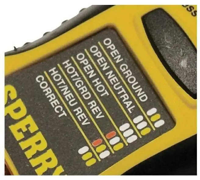

Thank you. & I used the Sperry Instruments GFI6302 GFCI Outlet Tester, the outlet was "hot," whereas the outlet in the next room read normally. I was thinking of trying to fix the outlet but I honestly have no idea where to begin with that and figured it wouldn't be a big deal to just plug the Furman into the extension chord which was plugged into the good outlet in the next room.
When you say "hot" do you mean "Open Hot" as indicated on the tester? This would imply the outlet is dead and won't power anything. Is this correct?
Oh shit! Thanks for responding. I somehow missed that and didn't take the step to look up the tester itself. I just assumed when he said it wasn't grounded.... He did have his gear running with the outlet from what I understood.
So this is either a potentially fatal/dangerous situation, a simple reverse of two wires, or a combination of things that are all not good.
Find out what is wrong with that outlet KP!
