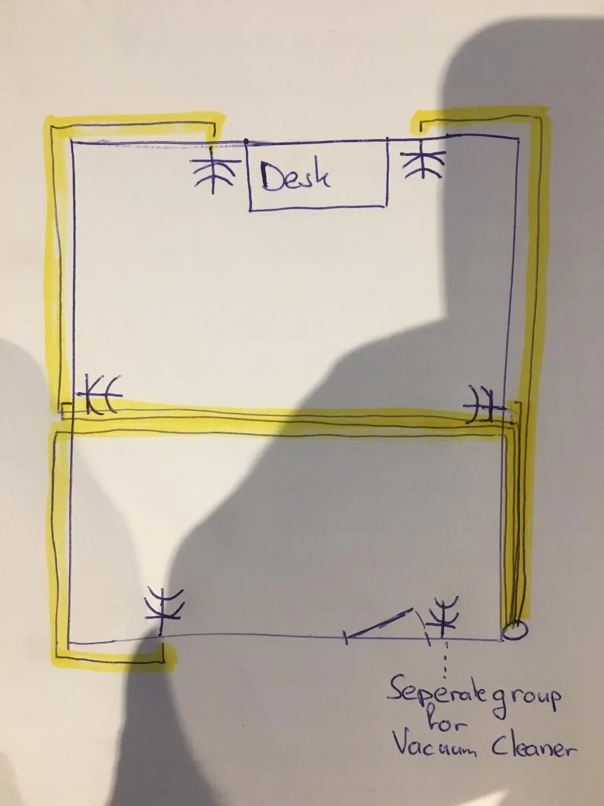

So after finishing my studio in which I tried to the electrics to the best of my abilities I still have got some questions that I can't easily find answers to.

So I tried to lay out the electrics in a star pattern. Since I was rebuilding an existing room I could not reach underneath the floor well enough. The ceiling was to high up and would have meant loads of very visible electrics piping across the walls. So I could not make the electrics from the middle.
I however measured out all of the earthing cables and cut them on one length. I did not lay them around the walls to prevent building one big loop. And when I had spare I wrapped it very losely and switched the direction in which I wrapped it every other loop.
All of this looks like:
Around my Desk, plus screen, I have got a pc, subwoofer with two monitors, Interface.
The rest of the room has usually got a guitar tube amp, bass amp, and an amplifier for the PA (for band rehearsals)
Lights are on a different group with a seperate earthing lead.
