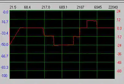

Here's a clip of my Kick => Kick EQ Demo
The clip is:
Dry Kick as recorded...
followed by EQ, compression and a bit of gate...
followed by the full kit...
Here's pics of my kit
I have a 14" Genera G1 Clear taped to the Batter Side... no padding... I can dial in a lot more click if needed.
Here's my EQ curve

Sonixx said:
My impression ...FWIW
I didn't get the impact that I expected. The kick seems to lack body and is a bit flappy.
That's without any tension on the heads. You have to step back about 10 to 12 feet before you get the thump.
I posted that as a lesson, and you got it right away. Don't tune your kicks as low as they will go. Tune them up above the shell's fundamental, so that the thump is higher in pitch - otherwise, you'll have to stand back to really get it.
Tim
