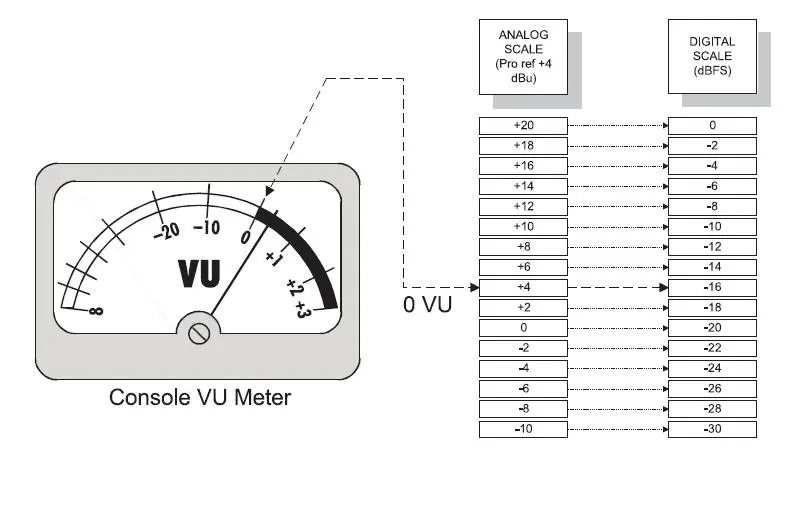

When you say "board" is that a console that you're plugging mics into to go to a daw? What make and model? Also you would be going out of the console through a AD (analog to digital) converter if it's an analog board to get to the daw.
When you say it is peaking at -3 dBfs in the daw and then comes out on the track view as -15 thru -8.. Is the track view in the daw or console? does it still peak at -3 dB in the daw?
This seems more like a tracking / mixing situation and not so much a mastering situation (as I thought it was) and if that is the case it could be how your trims are set up on the console or how your converters are calibrated or any number of things.
Here is a chart to help understand how the levels would differ from the analog console to the digital metersAnalogue - Digital scale.webp
Nice chart! And this is all about the DAW, not the console. And you are correct, it is more about tracking, not mastering, however I do some mastering as well. If I attempt to master what I record here I have the same issue. Sorry I wasn't clear enough. I'm using a Tascam M-1600 analog console. There's 4 - 25 pin cables that attach into 2 M-Audio Delta 1010 AD/DA converters. From there on to the DAW. This gives me the ability to record 16 tracks at once (direct out, bypassing the standard 8 bus and mains).
All the metering I am referring to (except for initially setting up a reference point for the mics on the analog console somewhere near zero) is on the DAW. So, I adjust the levels on the analog console to make the meters on the DAW peak around -3. This is actual input from the instrument, driving the mic through the chain of equipment to the DAW to make the meter of the DAW software console do it's thing. Then I do a take. I expect to see the same levels at playback on the DAW software console. Here in lies the issue. The software console will not show the original levels, nor does the actual track in track vue.
Thank you so much for reading this. And it sounds to me that you are agreeing this is a calibration issue. I'm beginning to think it's between the software and the disk. I don't even know if that makes sense.
I see what you're saying now. It seems like it's a set up/preference thing for the track outputs in Sonar. This might help to make sure the meters are set properly: Sonar's Hidden EQ
