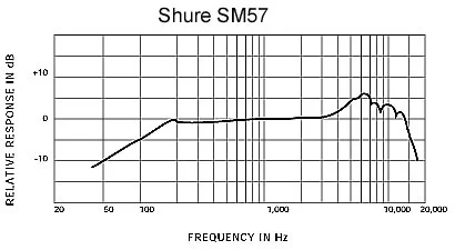

Word to that. Tech won't tell you how it sounds. I bet any amount of money if I took my 414 and my 57 side by side 9 out of 10 people would not detect any more air on the 414. Like I said, maybe a bit of grit but the 57 has plenty of top end for even drum overheads. If you don't think so you are deaf or you have never tried it.
If you get "dull" with a high end bump like this you are having serious recording issues that we probably won't be able to solve here today. You may want to try a different 57, yours sounds like it might be broken.

"dull" is kind of a subjective term-- his "dull" may not = your "dull"
it's not that uncommon an observation that sm57's are midrange heavy and lacking in its higher frequency response.
dgatwood, perhaps-- if you're planning on using your 57's as hammers and such anyway, it's worth doing the boiled sm57 transformer-less mod and seeing if it works for you?
