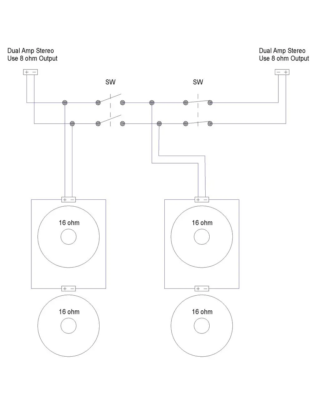

If it is indeed a stereo cab, it should have a switch somehow to isolate the two sides in the 8 ohm format. If that is the case then use the same wiring configuration. You just want to use the 8 ohm output from the two amps.
Remember divide if wired paralled, and multiply if wired in series.

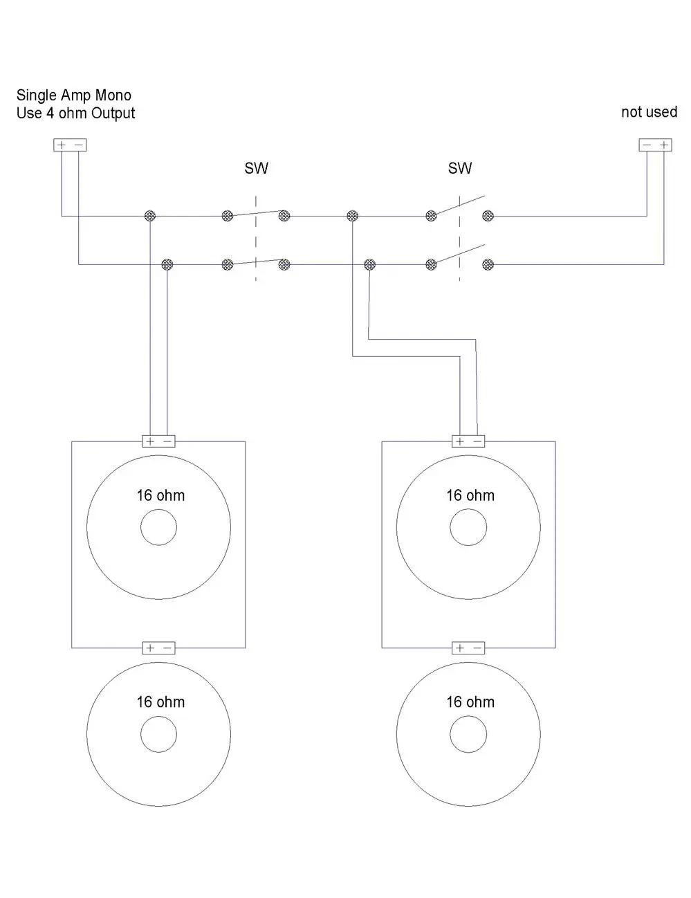

wow i spent too much time drawing this but here is an illustration of how a stock marshall 1960 cab is wired mono and stereo.

Currently, it can be switched to mono to run all 4 speakers at 16 ohms. Would it be better to wire it up to 4 ohm mono instead?
It depends on your amp. Does it prefer a 4 or 16 ohm load? If it's a tube amp and wants an 8 ohm load, it's probably safer to wire it up as 16 rather than 4. If it's SS, then it probably doesn't make any diff, except that you'll get more power from the amp at 4 ohms.
