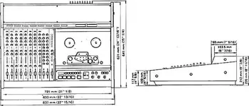

Does anyone have or know or can get the dimmensions of a 388? I'm in the process of "building" my studio on paper so I can shop and price things (my wife is big into planning.) So i'd like to know if a certain desk would hold it. I appreciate all the help you all continue to give.

Thank you so very much. You guys are all so great!!!
Good luck.
Keep us "posted". :)
Don't forget to leave yourself a couple extra inches at the least on the depth for connections in the back, ideally at least three inches.

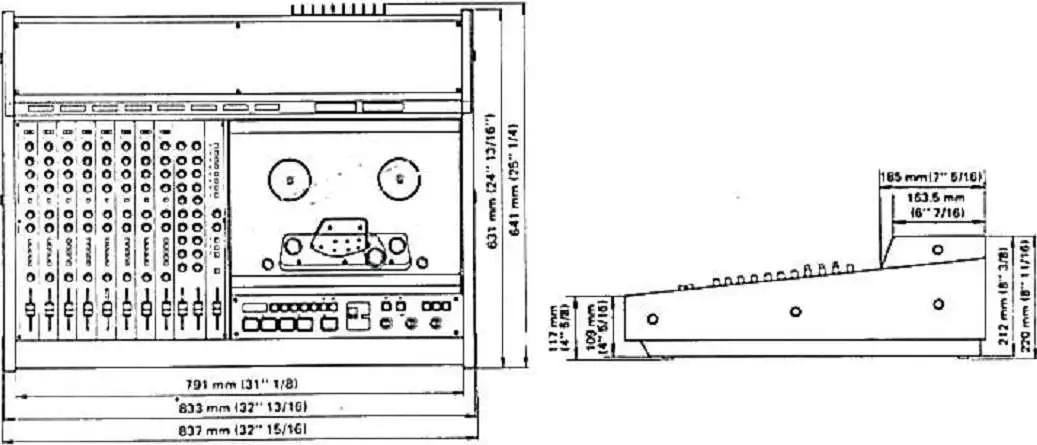

I sure will. I'm probably a ways out. Ideally I'd like to get one of those "studio" desks that have racks built in and I could put my mixdown computer there as well but I'm having a hard time finding one that would fit the 388 on the main work space. If any of you have any ideas I'd love to hear them.
