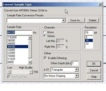

this is how i do it (cool edit pro)
Thanks for he quick response guys.
see the attached image guys.
this is the way i do it in cool edit pro. please let me know if I should do it differently.
