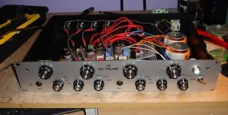

My next DIY preamp project is going to be a couple of channels of the JLM baby animal, I just finished a 2 channel valve amp designed by Gyraf in Denmark:
Since you are working on a bit of a tight budget (at least if you are looking to go the "quality" route), I would recommend building something like the Green Pre to cover your immediate preamp needs. That way you could put more dough into a killer interface and a couple killer mics. I would go Lynx or RME, and there are so many choices on mics it is rediculous. Might throw an AKG 414 or AT4050 in there; a good pair of small-diaphram condensors...
Dude, that G9 looks really wicked!!!

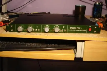

Yeah thumbs up for the green, very clean pre and costs very little to build.
Well, speak of the devil! There is a very nice green pre right thar. ^^^
How does that DIY Green Pre compare to Neve, Great River, etc?

I've never used either a Neve or a great river so i couldn't tell you. The circuit is based on the pres in the Amek mozart console if that tells you anything? No tubes or trannies so very clean, no colour or character to speak of. Not in any way bland or sterile though, a very nice sounding pre. Dirt cheap to build too, i think two channels cost me around £150 including case and knobs and everything.
I also recomend the Grren Pre for a Good DIY Project....If you source the Parts Correctly and etch the PCB"s your self you can Build one for about $75 per channel.....
I am just about finnished a 2 channel Green Pre I just have to solder a couple components and mount everything in the Case I made...
There are poeple on the Prodigy Pre Forum that will sell you PCB"s and Parts Kits and there is extensive documentation on the net of how to build them and there are several versions of this Pre, each with different Features, The one I am building is the First Version which doesn"t have a LED Meter or Phaze switching or a Trim knob but it does have Phantom power and up to 66db of Totally clean Gain...From reviews I have read they are some of the Cleanest pre"s to can Get .....
If you need info on doing this Project just ask....
