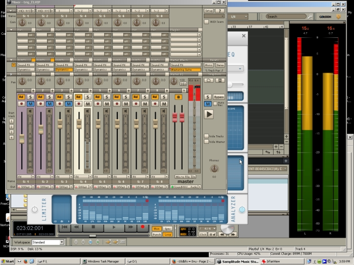

I just like the pretty colors : ) I guess I'm 14-16 over, or, something

Using the t-racks metering plug. Should I observe the rms meter (bottom left) for average dbfs levels?
Is it this?
IK Multimedia | Metering
A quick read I couldn't tell if thye do peak + RMS- or if you have to use two separate views'?
In Sonar it's so- intuitive. The RMS (on typical instruments/vocals and such) hangs out towards the bottom (duh :>). But then there's a bit of 'gap and the peaks are spots up on the top. This thing looks like one continual blur'? Interesting.

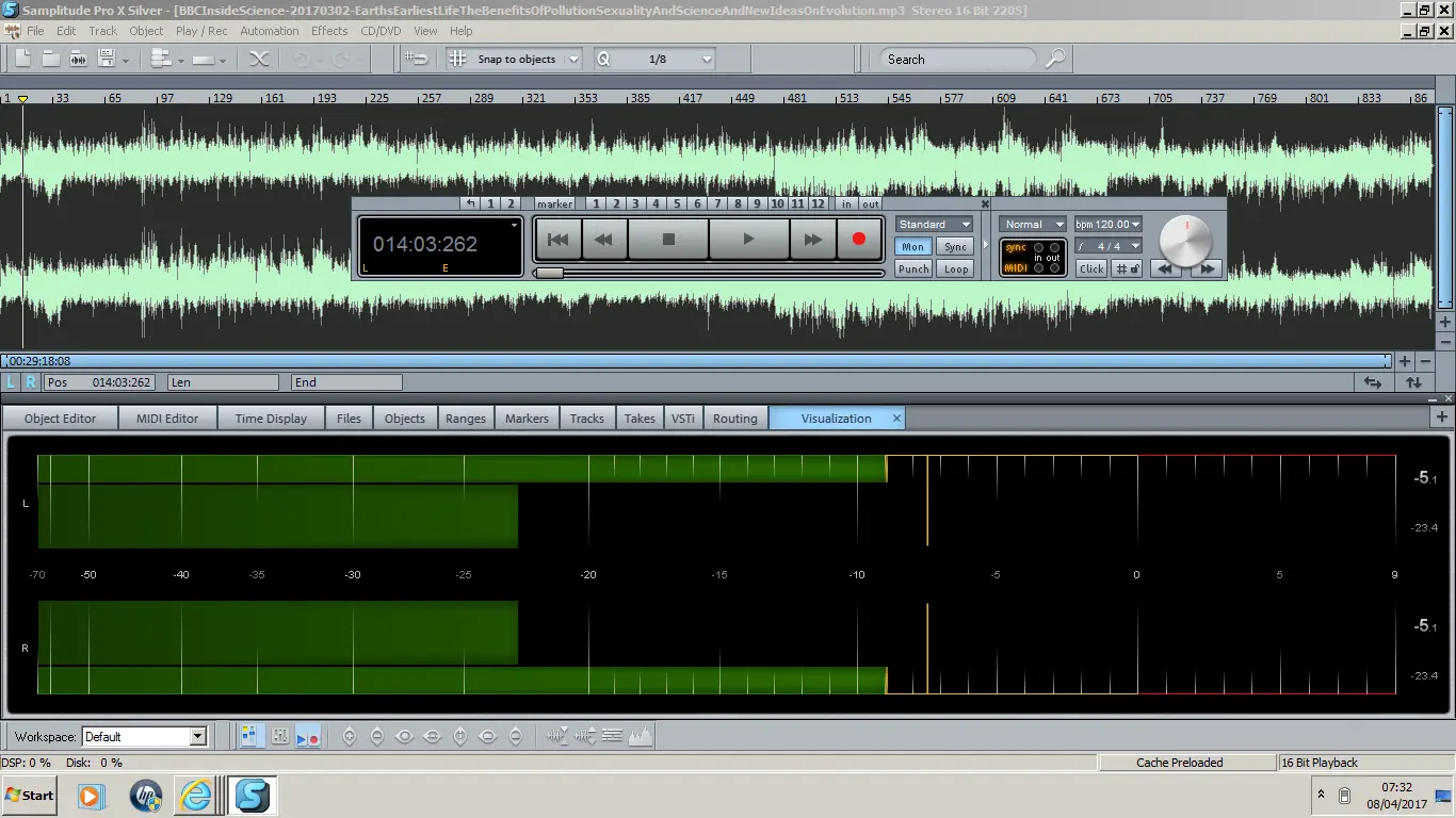

Attached is what I mean. You can work it out I am sure but the rms value is the broader, shorter indication.
The meter can be resized in X and Y directions and moved and parked where you like, removed from screen and incorporates an RTA and scope function.

Ya, I was tickled with that meter when I first saw it. My Music Studio version doesn't have all the displays of pro x, but I still get 5-6 basic displays ?
That meter is in the free Sam Pro X Silver. You only get 8 tracks max at a time but I think it is a great DAW for the noob.
